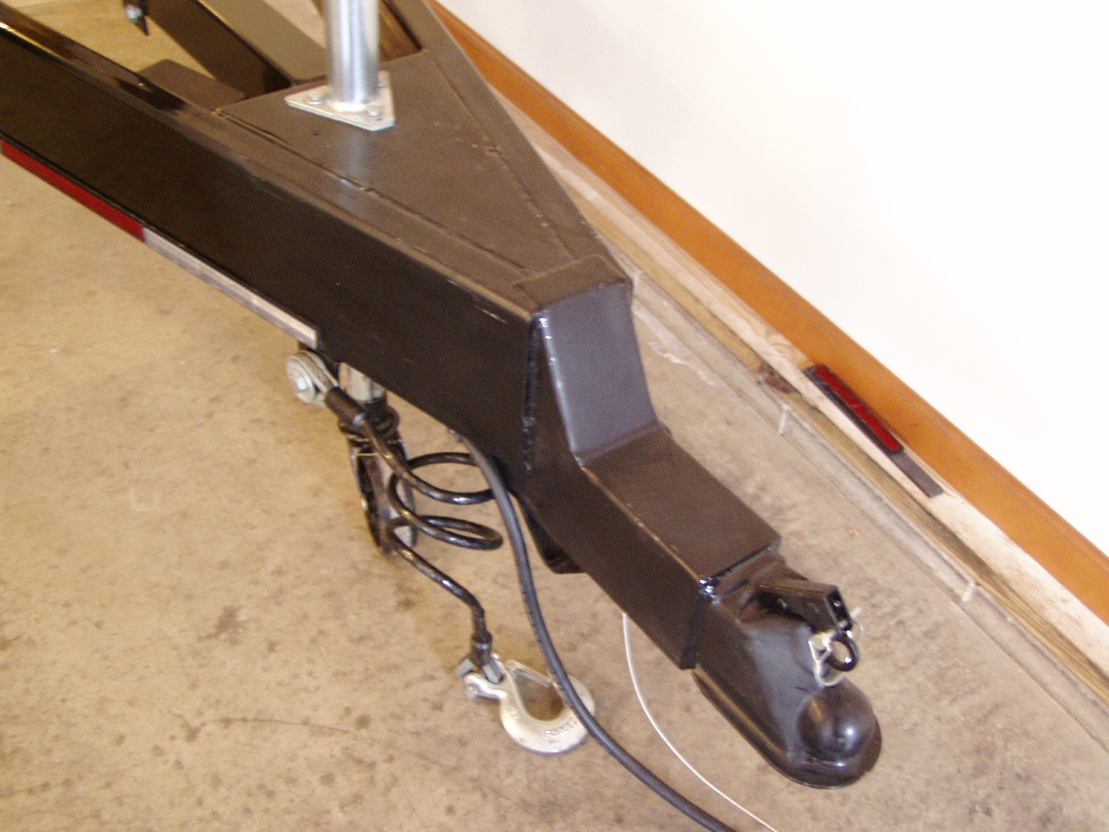

I cut off all the coupler roller brackets, welded in pins in the coupler slots, filled all holes, and also welded the coupler solid. Ground all plugs and filler plates smooth. Then took the trailer to an autobody shop to have it painted so it looked factory. Pics are prepainted
I believe by law, you have to have a breakaway battery setup installed. My breakaway battery was always dead too do to the once a yr use and my brakes worked when connected to truck. In a breakaway situation, I mighta been outta luck at 1st until battery recharged while towing.

I really like how clean yours looks now, without all the surge actuator stuff there. I have been pricing new couplers and channel mounts and they are fairly outrageous for what you get, plus you will probably have to weld it on anyway, so why not do what you did and just weld what is needed on the current coupler.
I think I am going to gut my surge actuator parts and weld a large heavy washer onto the coupler and back fill it, so I can just thru bolt it with a same size bolt instead of a pin (3/4" maybe, I can't remember) that is used now. Welds won't show and the coupler will be solid for the EOH system to be mounted. Also, want to build a platform behind the winch stand to mount everything nice and neat.
