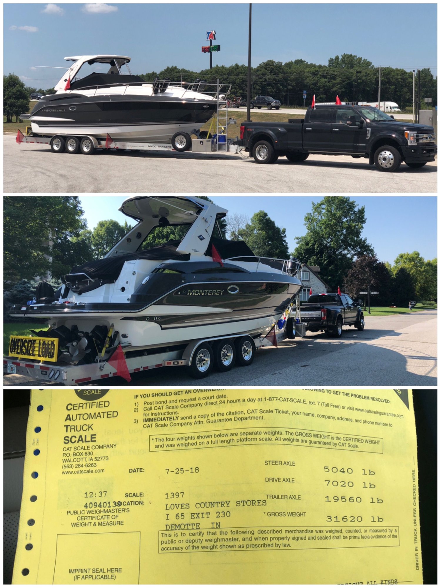

Current tow rig

havr you scaled the trailer? Any idea where the bot and trailer is at

f-350 will tow combined gross 42K with gooseneck/fifth wheel. My 17 does a fine job with my 400SS. It rides better than the 17 F-250 that I just sold. F-450 pushes you into different insurance class and is not necessary for what we are pulling.

I have a 2018 450 Limited that I DD and tow our 34’ cruiser with. I have not yet towed our 43 Donzi or 39 Nor-Tech with it yet, but this boat is heavier and way more wind drag. Pulls it perfectly fine. I get about 8-8.5 mpg @70mph. Absolutely love the truck!
