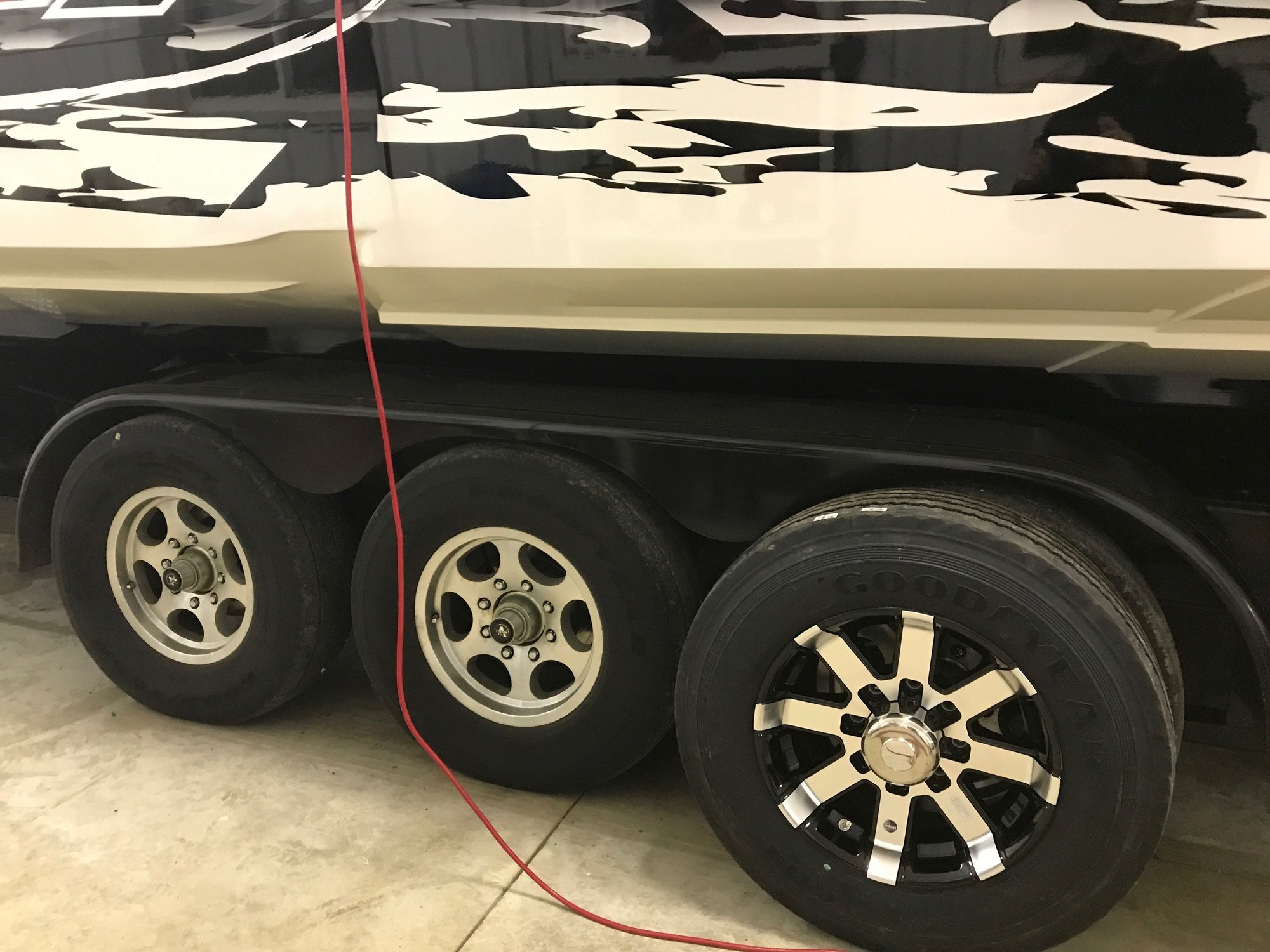

17.5 upgrade from the 14 ply 16" setup. Appreciate the reviews in this thread, helped to confirm this as a sensible update.
