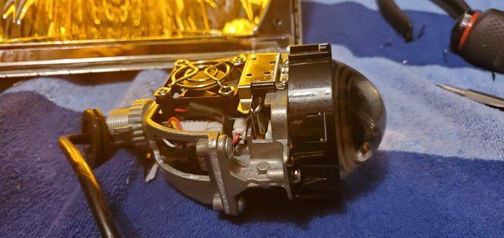

I have a 1997 Prevost Marathon MotorCoach and the headlamps SUCK!! They are OLD SCHOOL 1991 Ford Bronco/F150 square headlights. I decided to upgrade them with a focused LED Projector and could not be happier with the results. I also bought the Porsche Panamera LED trim rings.
I bought the LED Projectors here:
Amazon Amazon
You will need the Butyl sealant:
Amazon Amazon
If you want to add the LED Projector trim rings:
Amazon Amazon
These can be hooked to your turn signals and running lights to give a switchback flip from white to amber.
LED Ring and Projector mounted in the OEM bulb location
LED Projector unit
LED Ring illuminated for turn signal
Ready for reseal
IDLife Express is offline
