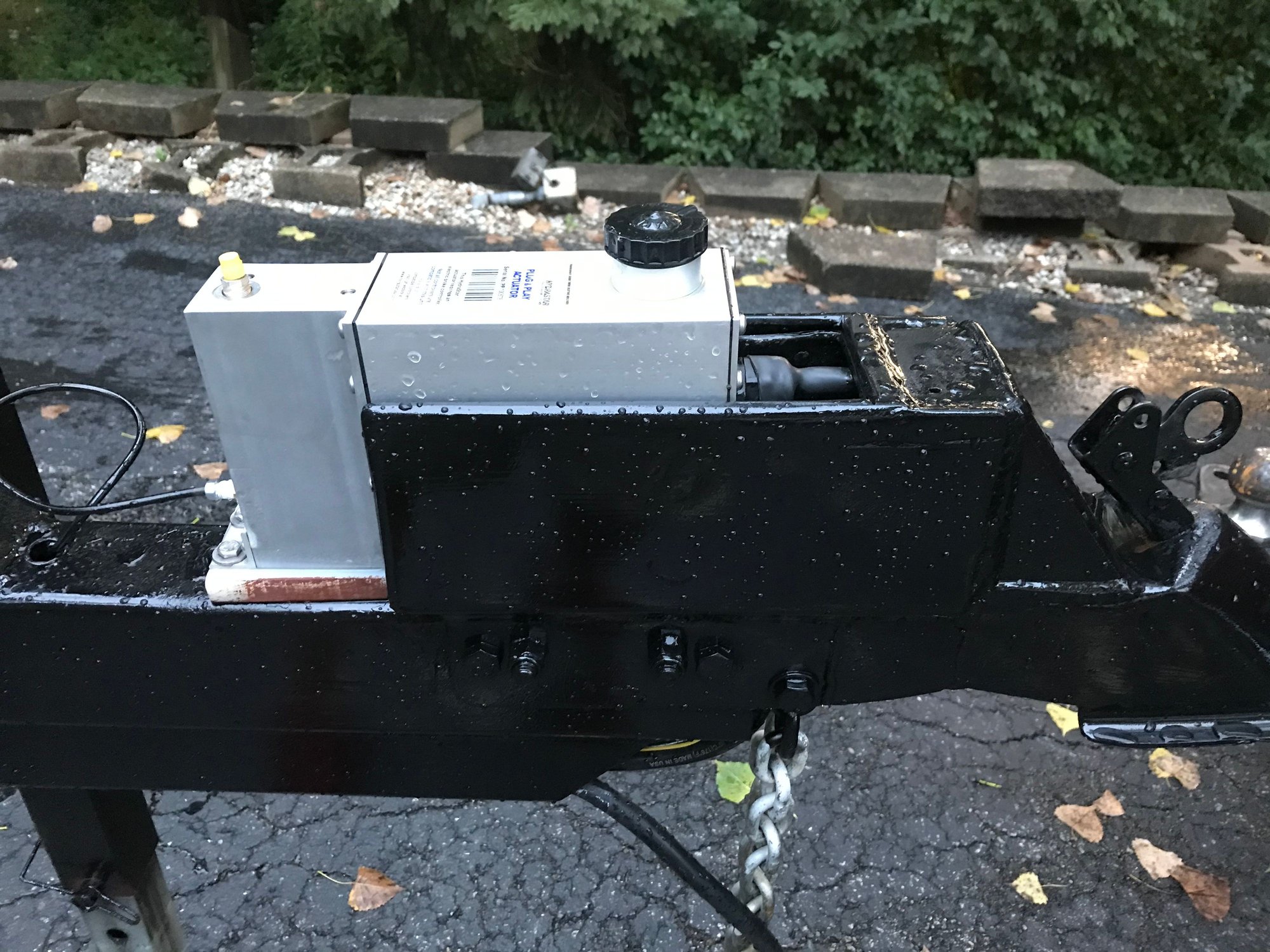

I just completed entirely rebuilding my trailer with new axles, brakes, springs, etc. the only thing I used that was original was the side rails. I agree with Dunnitagain springs are the way to go. Like stated take the time to plan it out with the correct weight springs and it will ride great. I suggest Kodiak stainless disks and Hydrastar EOH master cylinder.
