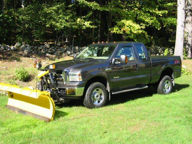

Ive got an 05 F250 SD with 95k on the clock and its never done it.
I had an 05 F350. Same here. Never any kind of death wobble. That's usually/used to be something for lifted rigs that don't have a good stabilizer set up. 100k on the clock and plowed New England winters for quite a few years with it. I couldn't have asked for a better truck. Been starting to look for a newer one.
