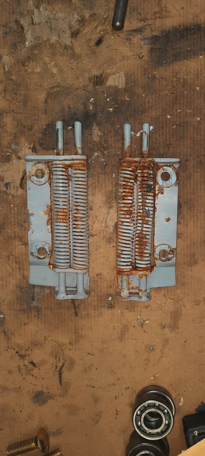

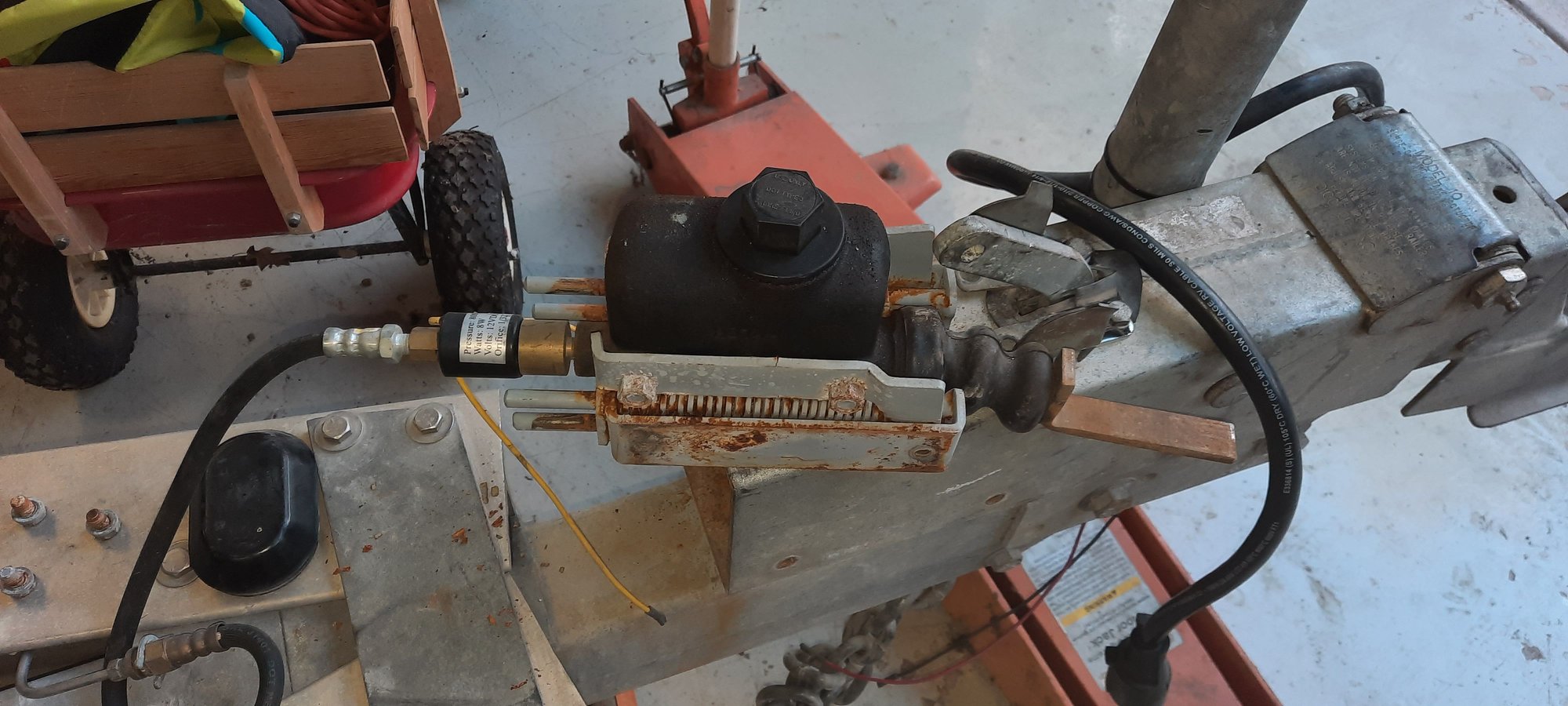

Think I found the issue.
I was using the breakaway lever to bleed the brakes just to be sure. Placed a section of square tubing over the breakaway lever for leverage. When acuuating the lever, it felt firm. However when I applied a bit more force, the lever moved considerably. Then noticed when I put the extra press on the lever, the master cyl moved aft a half inch or more.. Pulled the master cyl out and found its mounted to a spring loaded mechanism. After a certain amount of press is applied. The master cyl moves limiting the amount of brake press that can be obtained.
Now need to figure out what to do abt it. Wondering if the mechanism is sprung for drum brakes (that need less press than disc) to prevent wheel lockup??
Considering welding it together but still awaiting reply from Myco.

Joined: Feb 2013
Posts: 1,465
Likes: 396
May have to. Dont really want spend the coin since it's not getting used much. Also want to see what can be done with what I have now.
