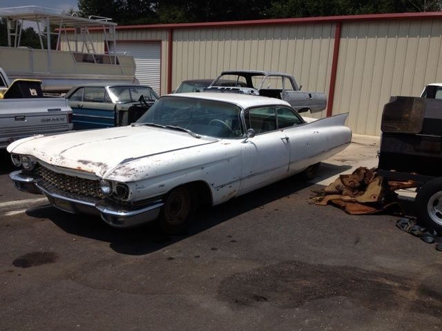

spent all day with an uncooperative '39 Ford Coupe and just checked a couple things before leaving the shop. have 12v and good ground to the aldl plug and 12v to coils but still no waking up of the PCM. hard to tell on the fuel pressure as by the time i put the gauge on it lit up the MIL light and tried to start but then nothing else and at that point it had 58 psi and held steady as there was no injector pulse after that. yes pump relay runs off the PCM. looks like this weekend I am going to pull the inner fender to get good access to the PCM and plugs to make sure a pin did not back out. this is the car
