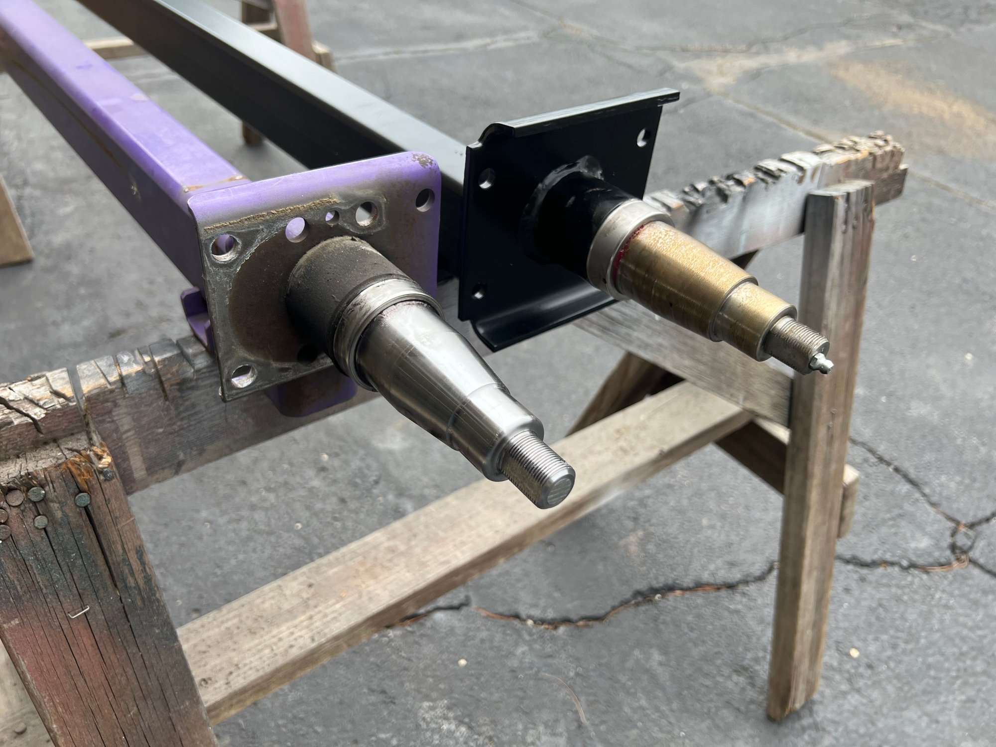

Brad Christy 04-18-2026 04:43 PM
Guys,
Turns out, K2 MFG shipped my axles to Heritage. Oops. So the rep at Heritage offered to meet me in Louisville and make the exchange, which actually saved me 2-1/2 to 3 hrs of drive time, total.
We got back home from Cumberland on Sunday, I dropped the axles off for powder coat Monday afternoon and got them back Wednesday afternoon. Kewl. It’s all coming together….
Dropped the boat in at our local overgrown mud puddle, spent the day cruising around. I can’t WOT it yet, as we still have the tuning to be done after the cam swap, but we have the WBO2 in and closed loop on, so we were safe, but the 30” prop is going to work out great and I love the feel of the new full hydraulic steering. We then parked it for the weekend at the marina. Came in this morning and got to work pulling the trailer apart, and discovered this….
https://cimg4.ibsrv.net/gimg/www.off...90f33af7c.jpeg
The purple is the old axle, and the black one is the new. They are obviously different.
I sent the pics and called the heritage rep. Somehow, somewhere along the way, he got confused and thought my trailer was a 2011 model instead of 2001, and, apparently, they changed the brake configuration somewhere in the interim. So he’s sending me the mating caliper and bracket, free of charge.
I had also ordered new bearings, races and retainers from Heritage, as well as new U-bolts, lock nuts and lock washers from McMaster-Carr.
We are now at a dead stop until all these parts come in (should be no later than Wednesday), but at least I’ll have everything axle-adjacent new except the hubs. The axles do, however, mate up with the leaf springs perfectly, though, so I should be good from this point forward, $30/day marina slip fee aside.
Never a dull moment….. :faint2:
Thanks. Brad.

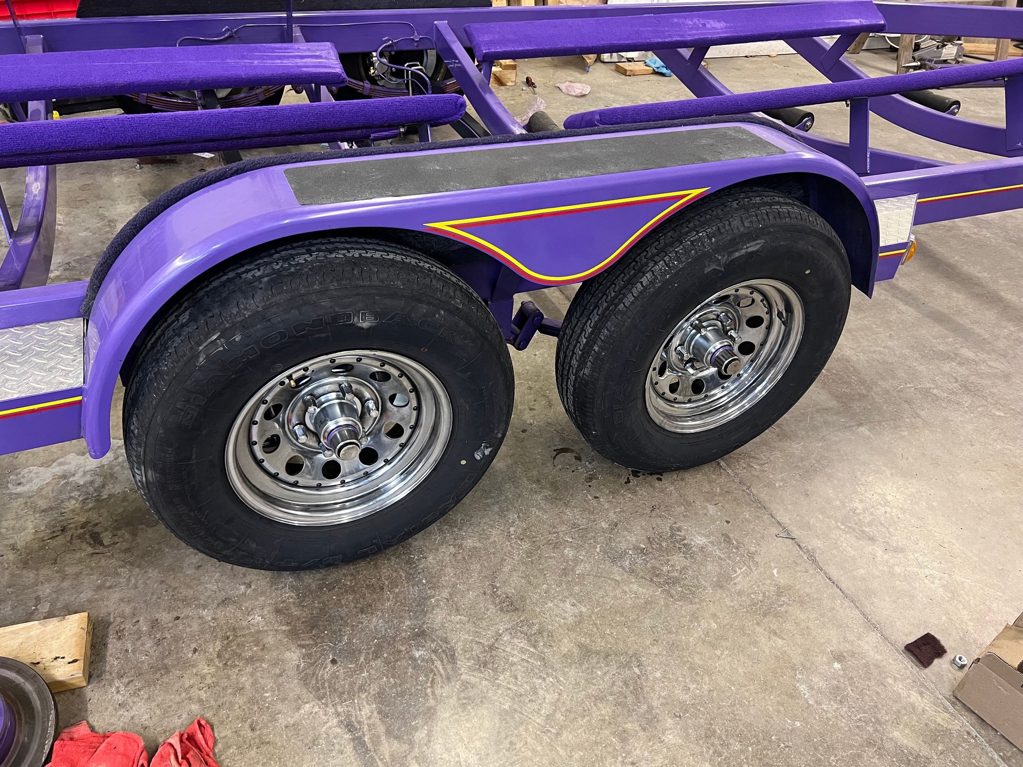

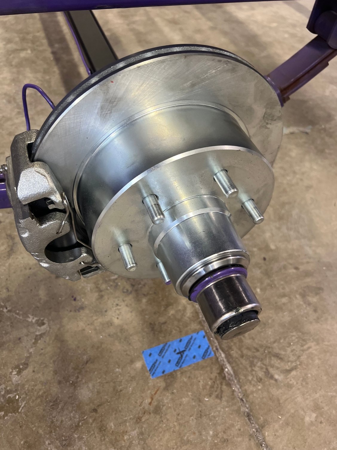

Brad Christy 04-23-2026 01:43 PM
Guys,
https://cimg4.ibsrv.net/gimg/www.off...20dd2f1c6.jpeg
https://cimg5.ibsrv.net/gimg/www.off...b49b79818.jpeg
Back on its feet. I made a set of adapter sleeves for my old Bearing Buddies. There were adapter sleeves on the old hubs, but the new hubs have a larger grease cap ID, so they wouldn’t work. These work perfect. And I really like the snap-in caps rather than the rubber “bras” that are such a PITA to get on right.
Went and retrieved the boat from the marina. Stopped for lunch on the way to the marina (no boat) and checked the hubs for heat. Warm to the touch. Pulled off half way back to the shop and checked again. A little warmer, but we could leave our hands on them indefinitely. Checked at the shop, after a short stint on the highway. A little warmer yet, but still not so warm as to not be able to leave our hands on them. No grease on the side of the boat or visible on the underside of the fenders. I think we’re good. Time will tell on the tire wear, but the spindles triangulated out perfectly after locking them down on the springs.
Thanks. Brad.
powerboatr 04-23-2026 03:33 PM
outstanding results, great to hear its all back and working as it should
i first thought those wheels look small.... then i noticed just how big the trailer is
