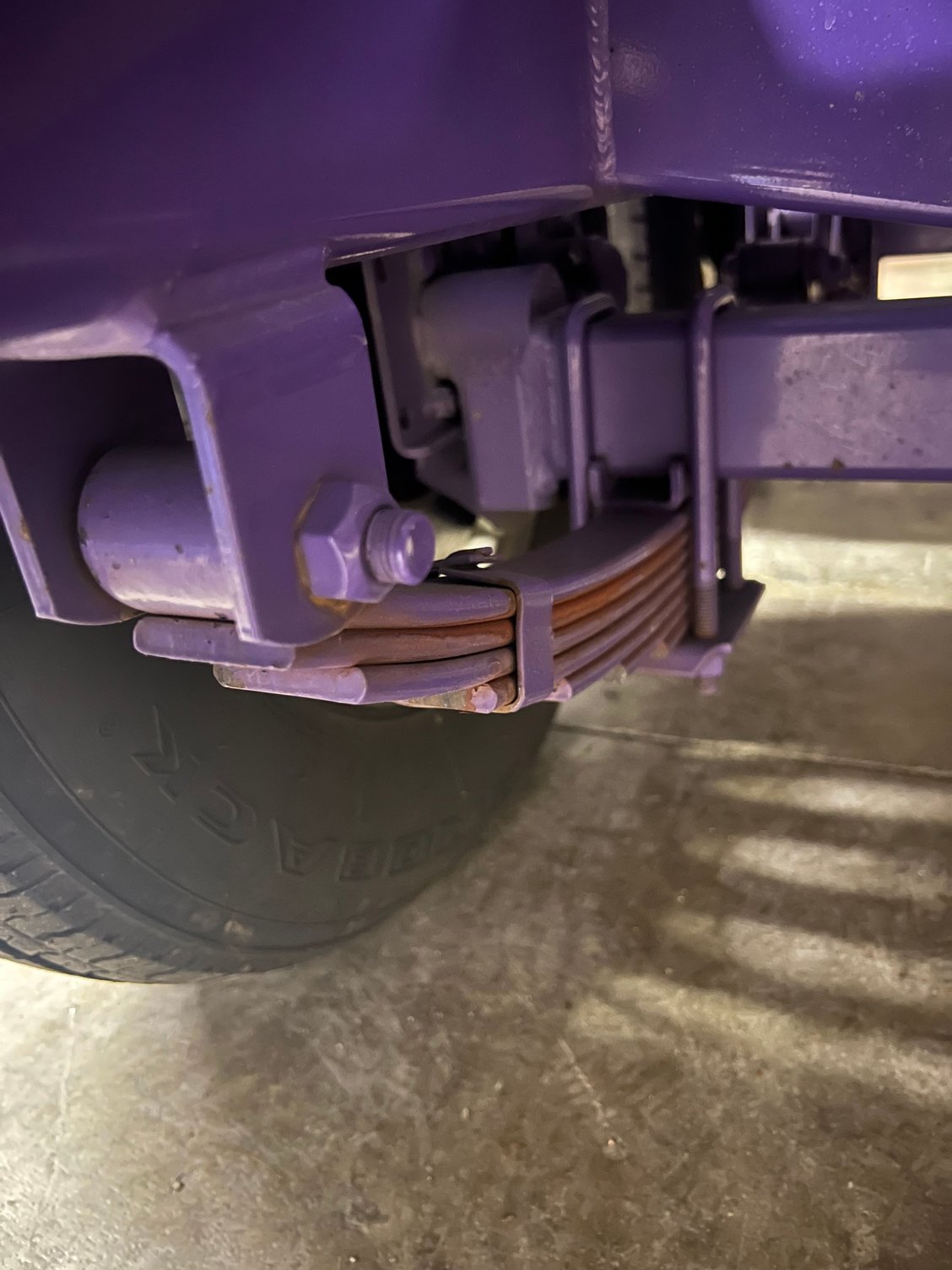

Are your leaf spring mounts welded to the trailer frame or attached with u bolts?
Brad Christy 03-16-2026 07:25 AM
Ryan,
https://cimg3.ibsrv.net/gimg/www.off...333d9b759.jpeg
Thanks. Brad.

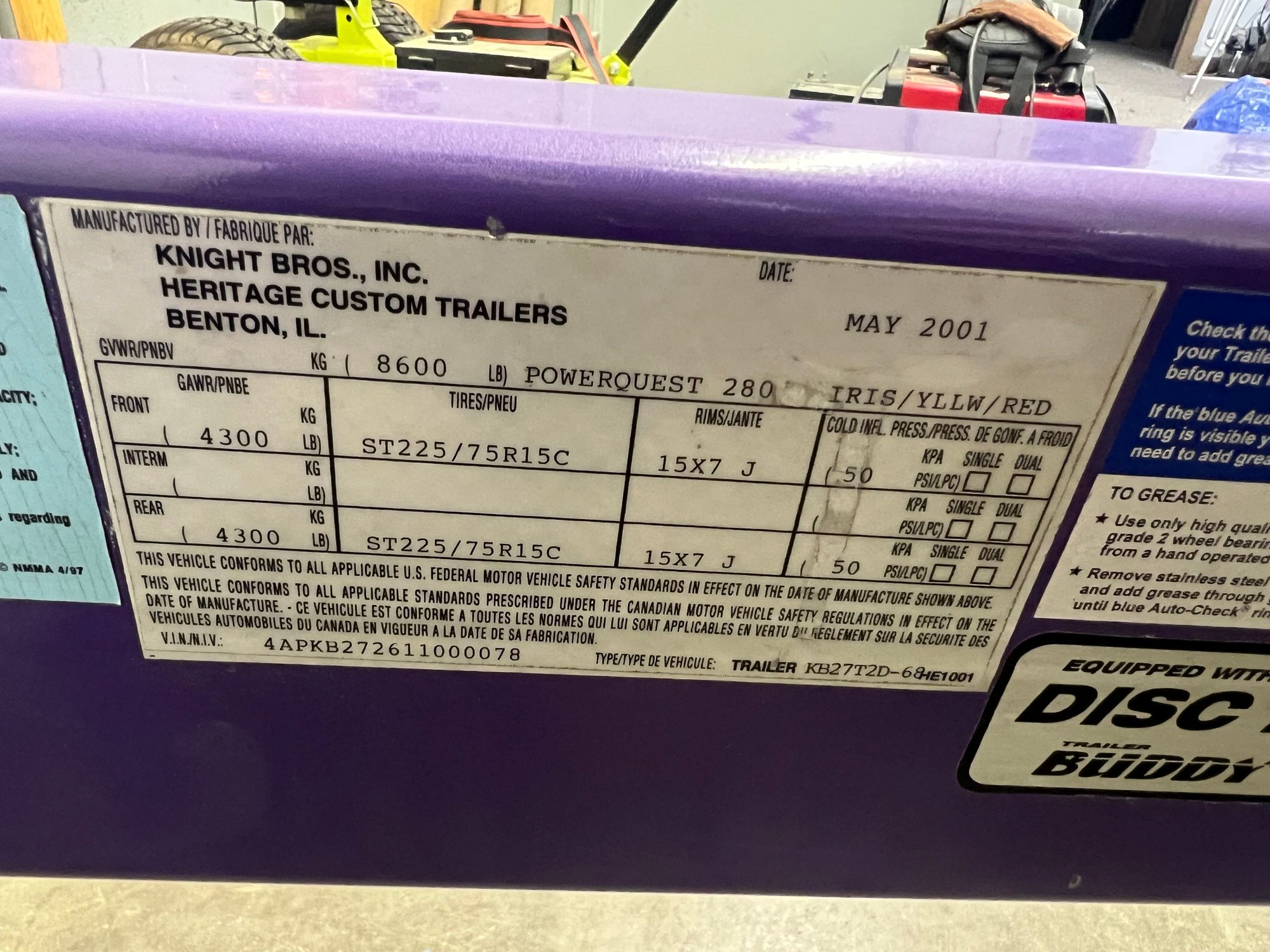

Brad Christy 03-16-2026 08:09 AM
Guys,
https://cimg6.ibsrv.net/gimg/www.off...95c8ca05c.jpeg
4300lb axles? Am I reading the right?
Thanks. Brad.
IGetWet 03-16-2026 08:56 AM
How often do you cut the trailer sharp backing it up?
ICDEDPPL 03-16-2026 09:39 AM
Yes,
8600lbs trailer .
How much does your boat weight ?
Brad Christy 03-16-2026 09:50 AM
Originally Posted by ICDEDPPL (Post 4944532)
Yes,
8600lbs trailer .
Dan,
4800lbs dry, advertised. 7K boat and trailer dry weight. Boat carries 600lbs of fuel with a full tank. That trailer weight capacity sounds about right.
just wanted to make sure I was reading the tag correctly.
I’ve got a call in to Heritage to confirm exact match, as best as possible. Waiting to hear back.
Thanks. Brad.

So, I just got a quote back from Dexter for a direct replacement, to Heritage's specs. Just north of $1700, for a raw beam with spindles. No brakes. No hubs They have THIS on their website for less than $500, and Heritage is telling me it SHOULD be a "standard" item. WTF....?!?
Thanks. Brad.

I agree. I've been on the website. They don't list anything with the correct spring center or hub face spread. I don't know if they do custom stuff, but I think that's what I'm up against.
B ust
