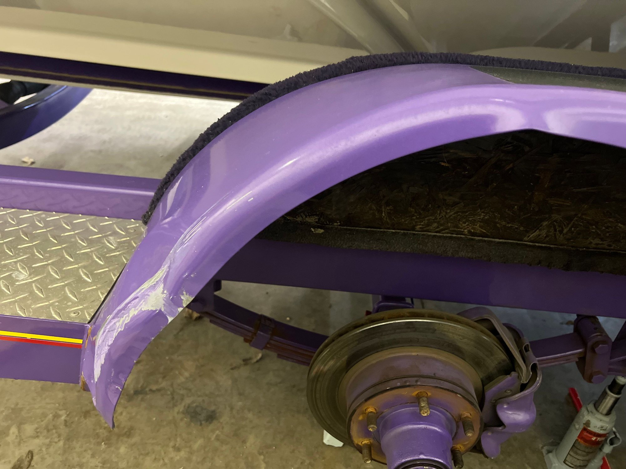

A few good curb checks will bend an axle. I’ve always been told you need to replace a bent trailer axle. I’ve had to replace the front axle on my previous two triple axle trailers due to irregular wear on the inside of the front tires.
Rob,
To my knowledge, no curbs have ever been hit, nor have any real potholes. But….
As stated in the initial post, there was an unfortunate incident in the parking lot at the ramp…..
I’m running on the theory that when this happened, the wheel/hub was hit, and that’s when the bending occurred, and it’s only this one wheel that was affected. Investigation will come soon. I need to call Heritage and find out exactly which axle I need to get, if that’s actually what I’m in store for, which it appears is the case.

Old 03-15-2026 | 10:03 AM
Joined: Jun 2009
Posts: 9,988
Likes: 6,483
From: Chicago
Axles are cheap. Replace axle. Trying to straighten them is complete waste of time.
I don`t know how much trailering you do but it`s pretty impossible not to hit a pot hole or curb at some point.
