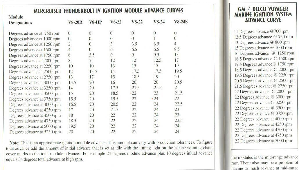

He's looking for the V8 HP module, they all have different timing curves
Confused. I believe mine is V-8 and not the V-6? Did not the HP 500 come with V-8 module on Thunderbolt IV.

yours in the swap shop is a V8-24S

Thought the V8 HP ? was with the Merc factory rev limit like my Bulldog540. I can look when I get home. That's why I posted the link .

It was my understanding that all of the IV modules were advance only. Rev limiting needed to come from another box.
