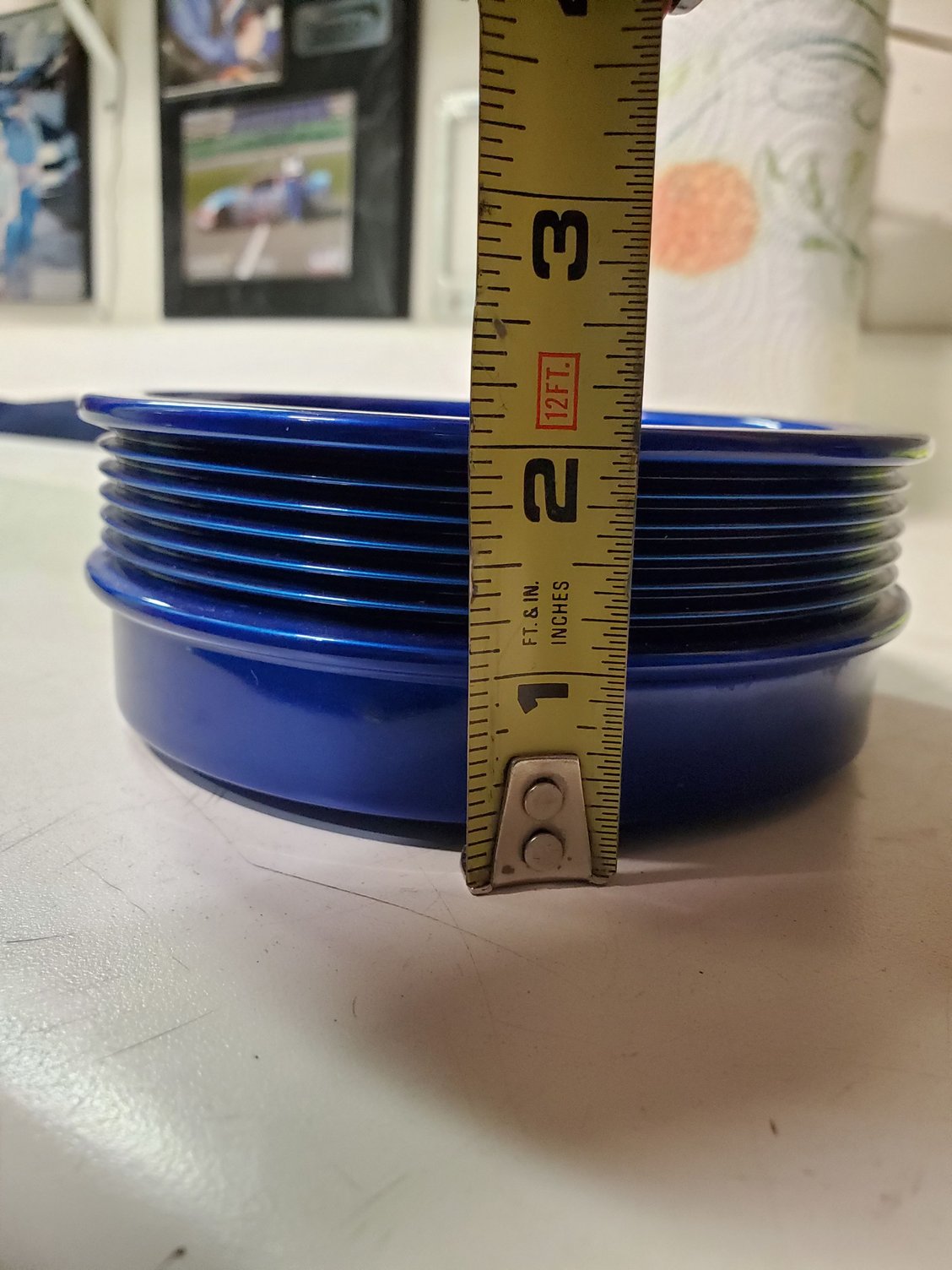

F2- I have a 2.3 whipple top mount that was for a 500 efi. I have all stock mag accessories and the snout is too short for the blower belt to run off my 502 crank pulley and line up. I need to either a: run a 500 efi offset setup to match or get a longer snout and a 502 mag crank pulley to match. And run my 502 mag serpentine setup.

not sure the difference but here's a 525 EFI pulley for reference
