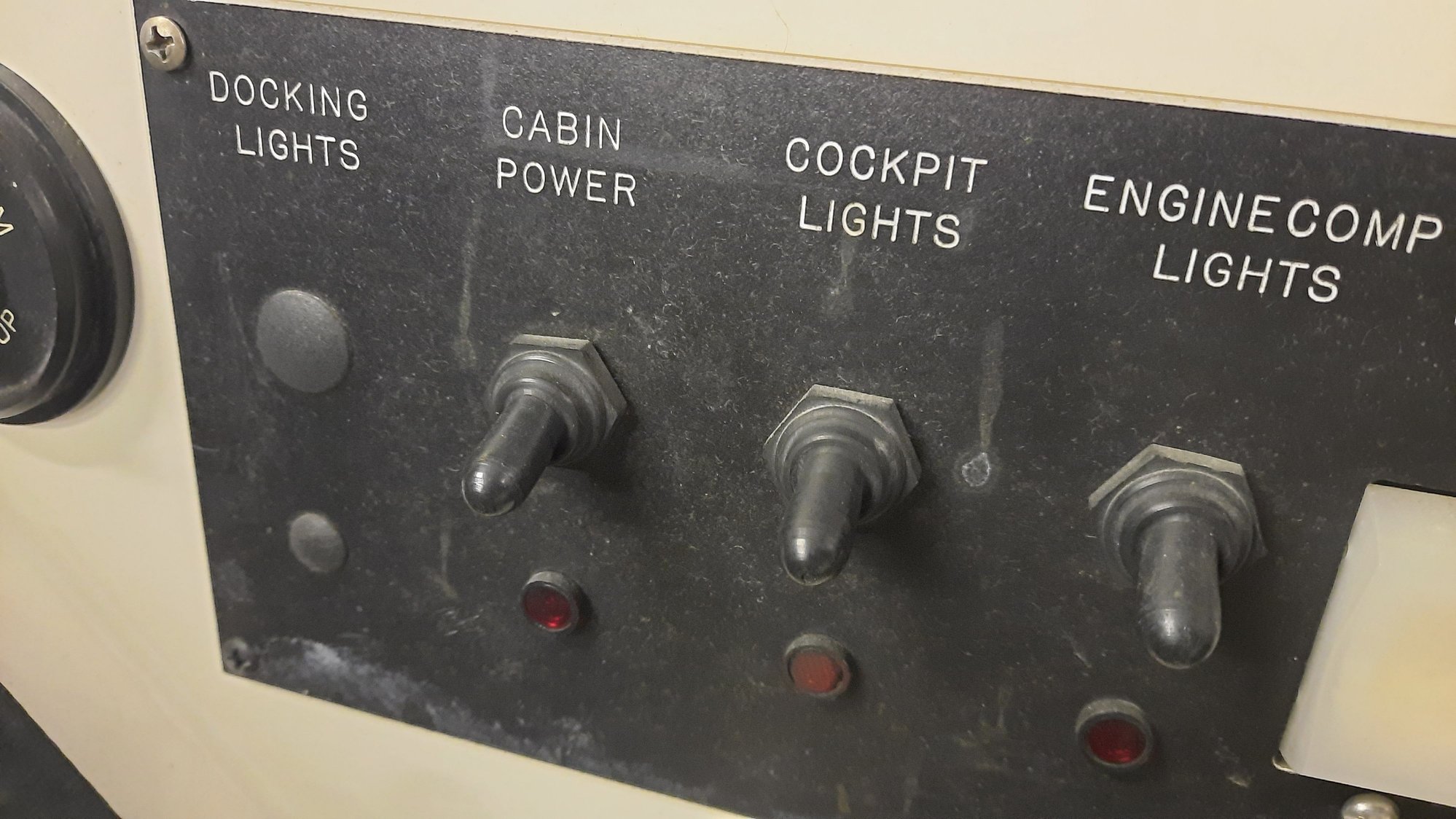

Wanting to install a switch where the docking light switch would have gone on my 1990 29' Fever. They are black and appear to be rubber coated. Not sure how many years they used those but they seem to be pretty common. Thx!

Post a pic. Many of the switches like that are also circuit breakers.

Many just use a universal rubber toggle boot cover

Pretty sure you are just talking about the switch that has a screw on rubber cover. You can get them a lot of places. They are nothing special.

The rubber cover is loose on the toggle and appear to be held in place with the nut. Just realized i need the little red indicator lamp assy too.

The nut should be molded into the rubber boot as that nut is what holds the switch in place (replaces the lone collar nut on a non-booted switch... they are replaceable at auto parts stores and amazon... ie.

Thx. Good to know the rubber part is readily available.
I was hoping someone had an old Fountain switch panel laying around with some good parts still on it.

Livorsi makes them.
