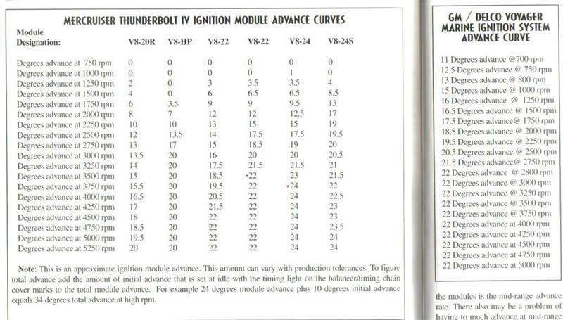

Here are the advance curves. You would be best off with a V8-HP and next choice would be a V8-24

I found this chart on this site, what makes the V8HP better, is 24 degrees total too much, its a 502 mag, factory, Rochester carb I believe, I had the Carb rebuilt and have replaced the coil. Oil stays clear all year round, uses absolutely no oil and has supposedly 525 hours.. Though it may have been refreshed in the past 31 years. Boat runs very well, but have been doing some research and am curious about slight performance gains that would help it get on plane much better. I am pretty much a novice here so what makes the HP better than the 24, and would I adjust my base timing to allow for more total timing with V8HP module? Or not mess with it at all?

You set your total timing to 32* either way. You just reduce timing at idle to 8* with the V8-24.
The V8-HP brings timing in faster and will give better throttle response.

i think most use the v-6 modual that has 14 advance you set the same top timing but it idles with more timing most engines love that its a bit cleaner and smoother its the reason we run the delco voyager est system on fishing boats the smooth idle stops shreading the flex plate
