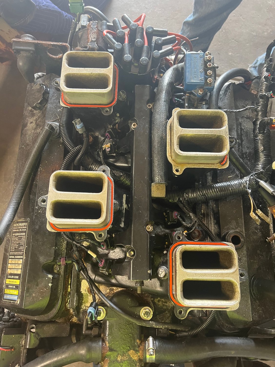

yes still interested. My new fuel rail (picture below) needs a line with an end like below pictured.
I’d rather have the whole line so I can take out the old (the old ends wont work) and just swap with another merc line. I just need one line as the top is the supply bottom isn’t needed.

How’s that going to work? That’s not a Cool Fuel rail. The Cool Fuel rail has a plug on one end and a valve on the other end to measure pressure.
The hoses that I have are for the Cool Fuel rail and the line bolts to the side with a brass brick.

Looks like the rail for the VST and not cool fuel
The VST has a plus and minus
Plus - the Reg on front of the rail sends excess fuel back to VST tank. This line can be sent back to fuel tank to stop vapor lock
https://www.mercruiserparts.com/bam/.../31910/2336/10
Minus - Without the VST need to reroute return somewhere

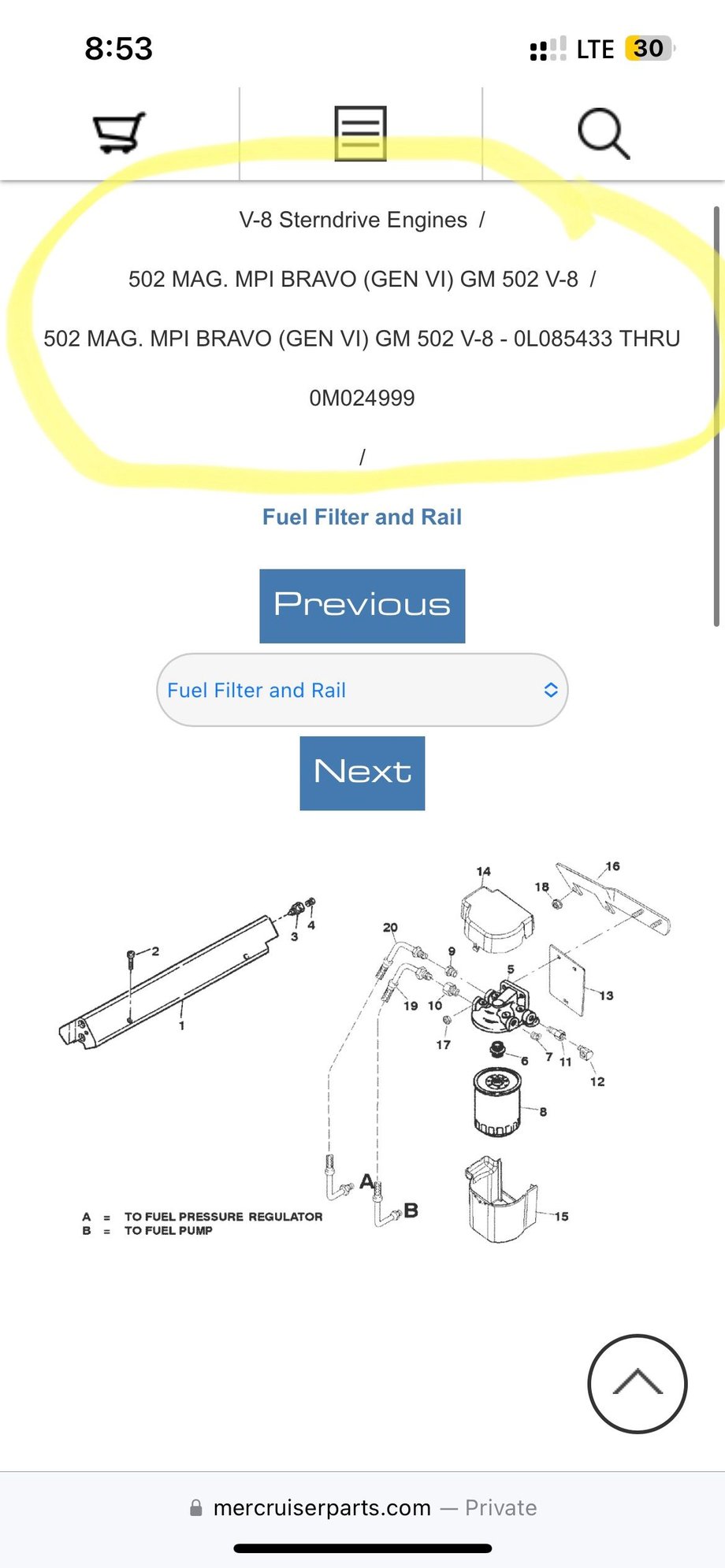

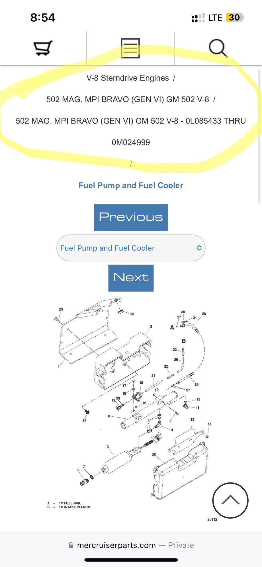

thanks for the info. According to the diagram this is the same rail as my SN. Here is screen shot showing cool fuel system (look at the model number motor at top) and the rail. Both same motor.
Am I missing anything?

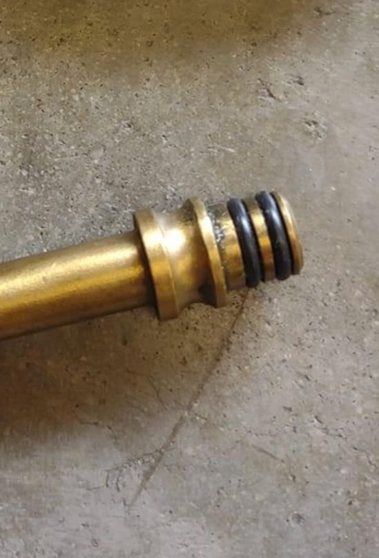

like this?
