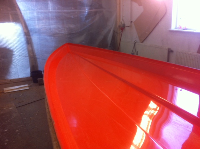

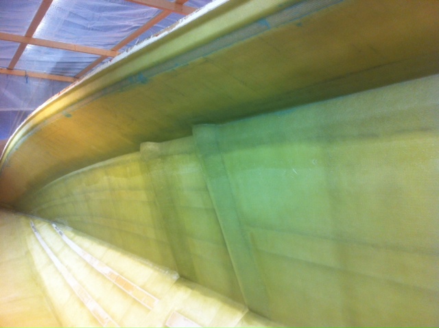

STBD side freeboard Divinycell sandwich laminate vacuum-bagged.
