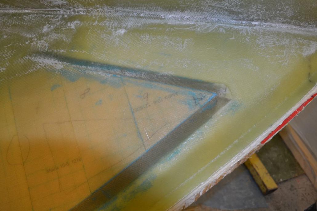

Since these pictures all the stringers are done, fire wall, bulk heads etc too. Next week hull and deck will go out the molds I really don't know yet If next boat will be a white race boat or if it will be a color "pleasure" boat. Following days will tell.
Divinycell core in freeboards.

Nice work...vinyl ester resin being used?
Thanks John!
This one is done with polyester
