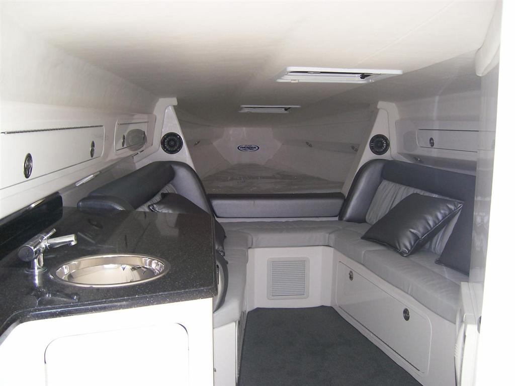

Right now the current 37' ATs are running 86-90mph with traditional transom mounted XRs behind 525EFIs. This is VERY VERY competitive, (if not exceeding), what the other manufacturers are doing; ESPECIALLY CONSIDERING your cabin looks like below with AC, Fridge, Microwave, Enclosed Stand-Up Head/Shower, Corian countertops, and a host of other cabin creature comforts that other manufacturers don't even offer.
Heck, ActiveShack's new 37AT turned 87mph with all of the above AND A GENERATOR.
Attached Thumbnails Staggered-101_0080-large-.jpg   Staggered-5.jpg   Staggered-head.jpg
