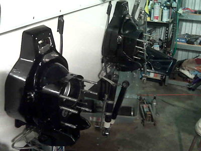

Gimbal rings installed, bell housings on with new gimbal bellows, new shift cables. No shimmy/shake in the transom now. Bender's kit works well.
Motors completed. Exhausts back on.
Waiting on outdrives which should be this week. Getting close.

See from the pics that I do need to remember to install the plate on the cutouts on the transom assembly.

Do you have hydraulic steering? Can't see the rams in the pictures.

Yes I do. The boat had hydraulic with cable at the helm when I bought it. I converted it to full hydraulic within a year of buying the boat. You can see one of the rams under the license plate on the 2nd pic.

I was just wondering, figured you had it. Looks Great! Love the J-R gimbal repair kits. Have one on our AT. Keep us posted.
