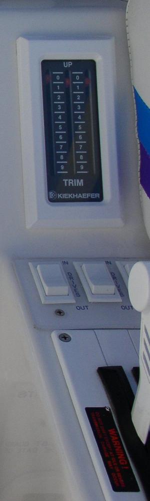

Does yours look like this? In this pic the tabs are all the way up but the drive trim indicator is disconnected with the cable pulled out. I would think that is like the drive being all the way up, if I push the cable in it goes to about 8. Any Ideas? Is the card different? The cables can only come in one side off the indicator. I'm missing something. Thanks, Doug

I thought the "0" is at the bottom and the "9" is at the top on mine. I will check tomorrow.
I do know that when the tabs are all the way in the up position, the indicators are at the bottom(like yours).

on my single I/O drive in tabs out all indicators are at the top and at 0.

The 25 cable comes in from the bottom and the 28 cable comes in from the top.
When the tab goes up it pushs the other end of the cable out. Hence why one is at the top and the other is at the bottom.

Thanks for the help everbody. What has me puzzled is the cheat sheet taped in the by the previous owner for drive and tab settings. I'm in London UK. now, when I get home I'll post a pic of it. If he ran the boat using those numbers, it had to be interesting. R Addiction, I take from the pic that both tabs are up and the drive is down? Doug

Doug, I checked today. Drive in and tabs up and they were all at the bottom(#9)
