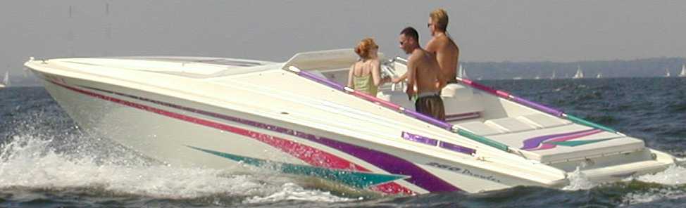

Just to compare to Sonic, and Fountain, and others with an integrated swim platform... when the boat is pitching up when coming on plane causing the swim platform to make a solid "cup" over the water; the air pressure building up from the exhaust will cause a vibration until you get the transom up out of the water. Attached pic shows example of this with my old 26' Sonic.
