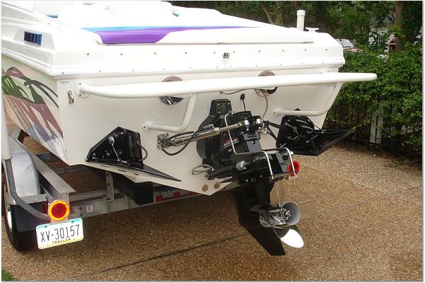

And I got the big ones for my 25

Tabs even with hull......lead the pack for 45 minutes down the bay
Hard to tell John, but the tab looks all the way up.......?
Set at 3.

I should have had them a little deeper on that run on the James!!
280's? I got 380's on my 25, there's a little bit more going on out back thoughI only use em when the ol' lady starts crying, which isn't often
