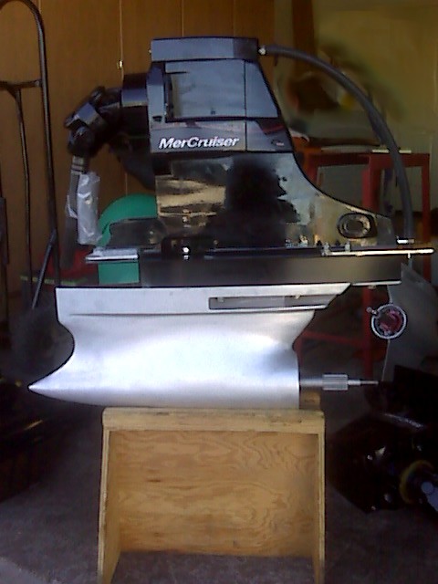

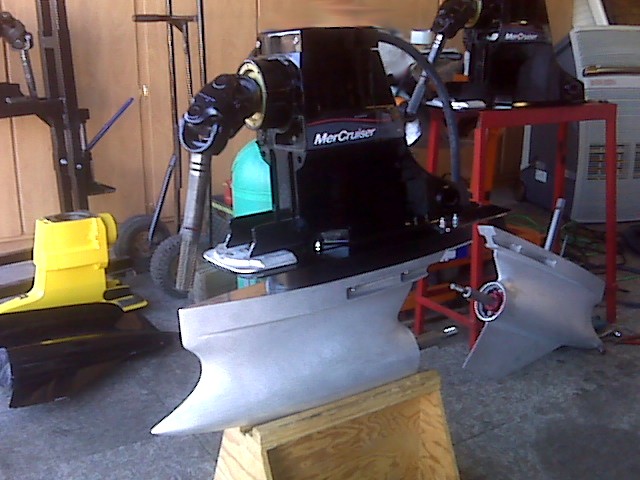

Originally Posted by laszlo01
Christmas in June !
Las is that a -2" shorty with an extension??? What is the plate on the back of the drive? Are they Merc?
Long time cult member.
Thunderstruck is offline
Old 06-01-2010 | 05:37 PM
  #223
Joined: Jul 2006
Posts: 1,558
From: Rockwood MI. Kalkaska MI. Sopron Hungary.
2" shorty with Imco 2" spacer to start off at initial drive height prior to tuning, Cavitation plate installed for when we start bringing up the drive height. Getting anxious now. New XR swept back upper and IMCO lower housings custom done up by Billet marine with all there components to hold up to the new power, trying to eliminate any weak spots as well as new HD gimbles.
