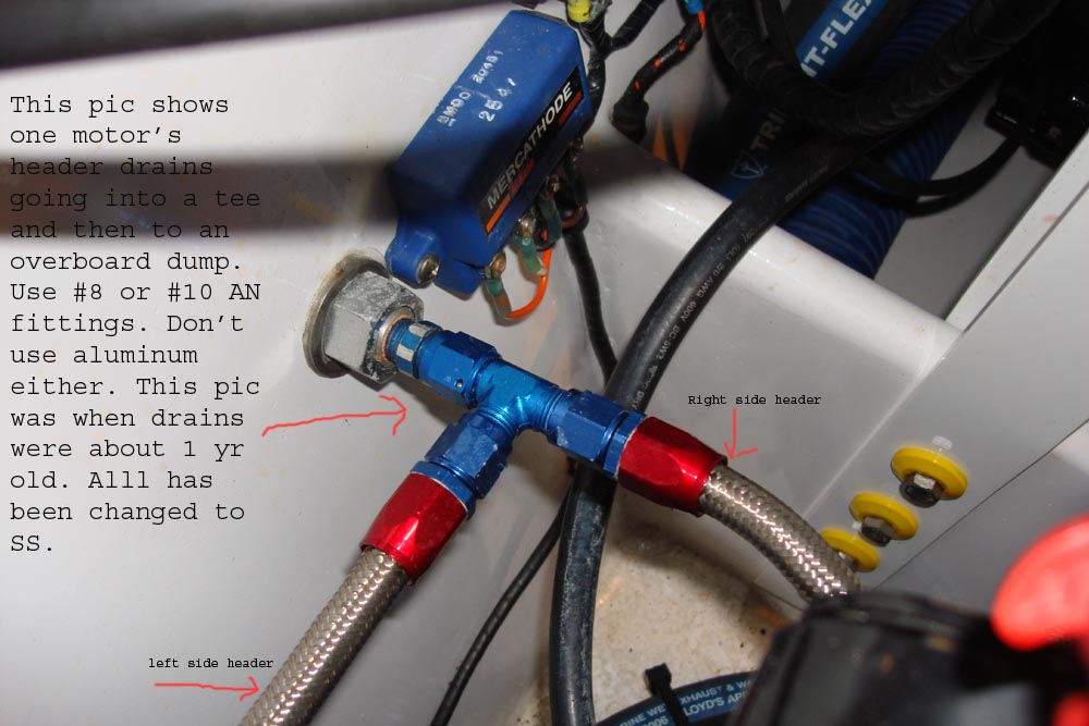

One way to help assure no problems is to install drains. These will drain header to an overboard dump so no water remains in header while not being used.
Yes water will flow while motor is running, but negligible on cooling ability.
This WILL make your headers last MUCH longer. Also, do not use 90 degree fitting as shown or aluminum. I am pretty sure the 525's have the ends (towards stern) on the water feed tube already threaded. You'll need an adapter to (std size) to go from what is already tapped into header drain to bring it down to #8 or #10 AN.
Eddie Marine has SS overboard dumps. Easy to install, and works!
Attached Thumbnails 525 CMI Header Issues?-header-drain.jpg   525 CMI Header Issues?-header-drain2.jpg
Great Idea. Someone should make a kit for this modification.
