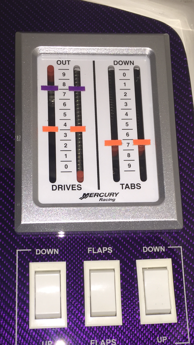

Orange on the indicators is neutral. Purple is max trim for running, prop slip is too high going higher. I don't actually need to trim anywhere near that high but I also trailer at that setting as well as anchor at the beach so it works for me. As others had suggested to find neutral take a long straight edge and place it on the bottom of the hull on the stern of the boat. Then trim the drives to where the propshafts are square with the bottom of the boat/straight edge. Then put a mark on the indicator, neutral for the tabs is where the tab matches the angle of the bottom of the boat.

Ok now I get it. I'll check to see where my neutral position ends up on the indicators. Thanks!

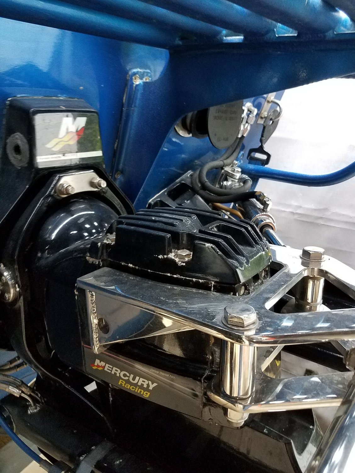

I would like to put drive showers on anyone know models that work? Dont think the Simrek Halo will fit but the Eddie Marine top mount looks like it may.

Their website isn't overly informative, but they have a setup that will work for you. I had them on with my Marine Machine steering system, just fine, as well as a few other folks.

I had the same ones as Brian. Great piece.

Since you have to remove the top cap bolts, take the time to clean the threads. Drive shore comes with new longer bolts. Anything you can do ensure these bolts stay solid is good preventative maintenance.
