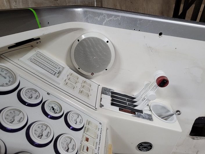

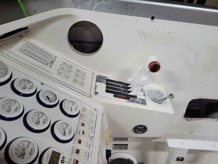

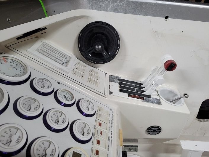

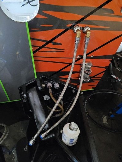

Made it out to the boat for a bit tonight. Installed new steering fittings and new stainless hoses.
Also solved the problem I had earlier of not being able to reach the nuts on the back of the upholstery inside the freeboard.

The stainless hoses look very nice on there and I did the same thing with the speaker hole myself. There was no way I could reach that nut up front on the panel stud. I bought new steering hose and chrome plated brass fittings for my steering as well. Also sent my brass 90's to the plating shop and had them chromed. They were super inexpensive @ $4.00 each to plate, because they can run them with other jobs. I you ever want anything like that done let me know. and I will put you in contact.

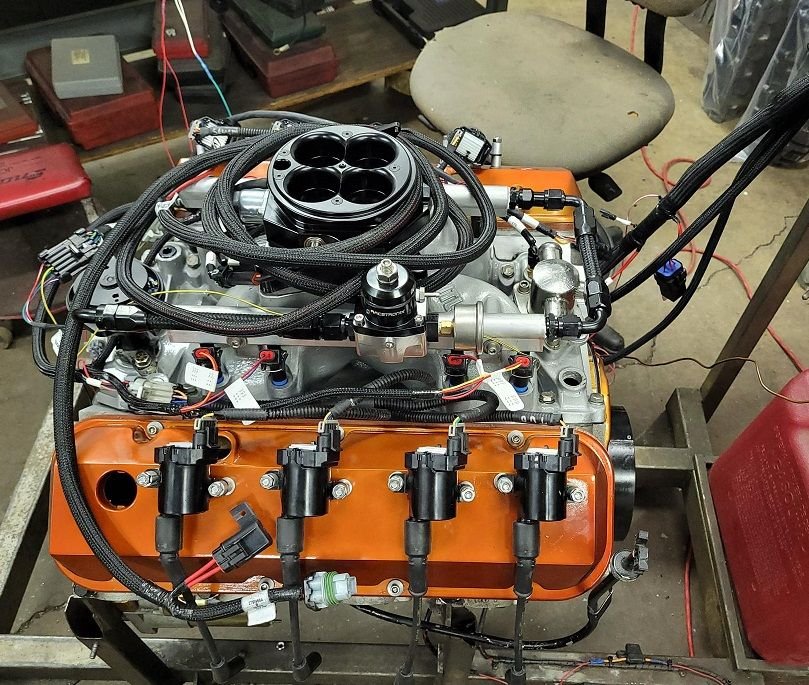

Second engine on the run stand and all wired up. I flashed the 2nd ECU with new firmware and loaded the Master dyno file from the 1st engine. Will fire it up tomorrow and break in the "refresh" and hopefully have the engines in this weekend.
