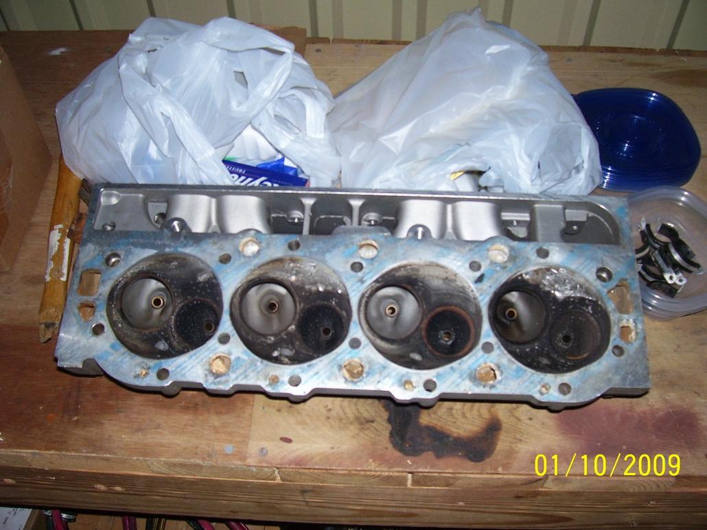

Starting striping the bilge down for paint this weekend. Matt (Excaliburhawk40) stoped by and gave me some help as well as some much needed advice - THANKS!!.
Looks like she will need new fuel hoses, bilge hoses, and hose clamps. One of the lube reservoir's was leaking so those will get replaced too. Debating replacing the battery cables and switches, but have not priced out. Anyone know the life expectancy of cables like that? Transom assembly looks good - was replaced in 2001 or 02. Replaced a hot water heater Grrrrrrr.......
Picture of heads shows the culprit. Pro Comp heads.......which I would NOT recommend to anyone.

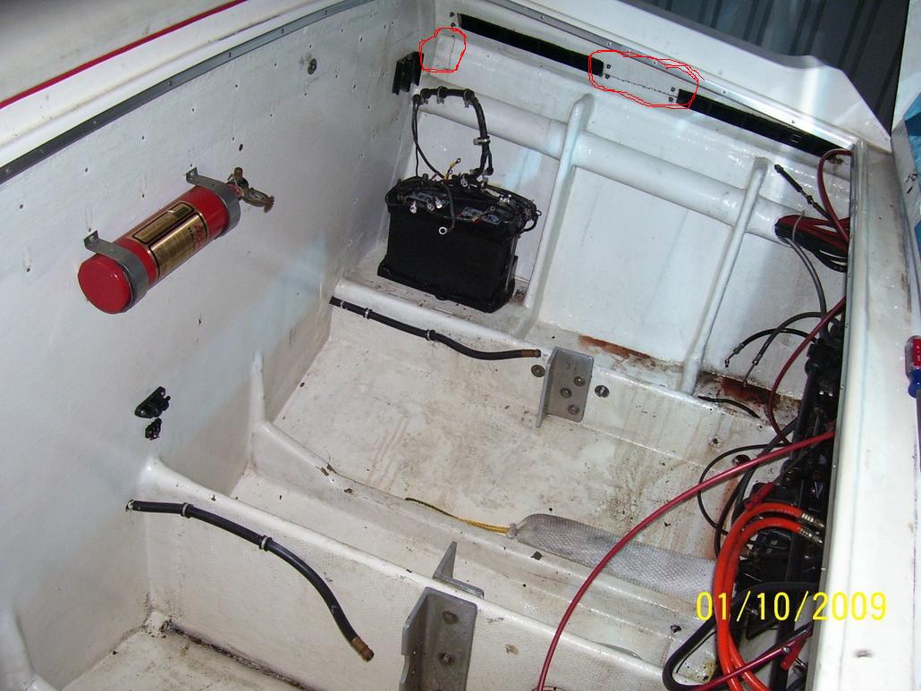

Yep, enough to call it a day. Found another spot that will need some fiberglass repairs made. The one spot on the corner of the bulkhead looks like that one piece of fiberglass cloth delaminated. Need to send that to Froberg to see what he thinks, or maybe he will chime in. Hopefully it is just cosmetic and the rest of the bulkhead is in good shape. Up close it looks like it wasn't bonded together properly to begin with.
Did you already get opinions on that? They don't seem to be in critical locations. Like you said, maybe never well bonded there. IMO... they are pretty high up in the hull to be of severe structural concern. I would be tempted to get in there with some west system while the bilge is open, sand it down and re-paint the bilge. Then watch it for a season and see if they pop. The one looks like a seam, not a crack. If they were at or near stringer tabbing I would say go see a glass guy.
