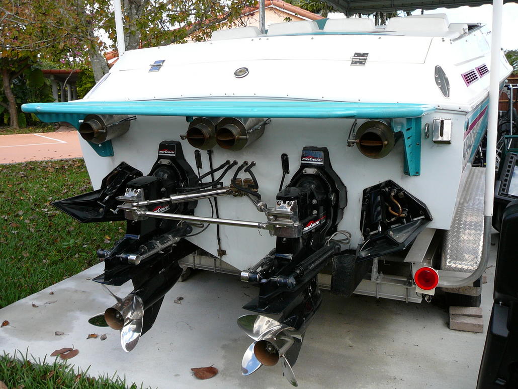

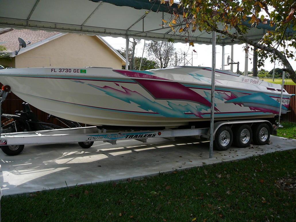

Yes I have looked at that boat, it looks like junk, the motors look like they need Serious work, it looks like a money pit, if you can the boat for 5,000 it might be a deal, I dumped 17,000 in fiberglass work into my old Apache 28 and it was in way better cond then that boat!!!!! just go back and check out my restoration thread, it will tell you everything you need to know.

Anything is repairable and changing a bulkhead is not that hard , if you know what your doing .
Cost for Bulkhead i quess ,,,,,,,,,,,about 1500-2500 $.
Also if the price is right, i would go for it.
The engines dont look that bad , i have seen worse and still running.
APACHE is a great boat ,thats for shure.
