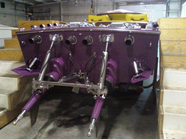

I have a 36' Cig with Arnesons on it.. Has a great running attitude the guy says...
