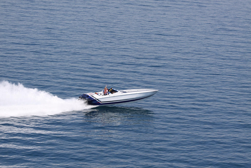

how does the cig run ? " look's nice "
Runs good. 104 ish so far with 540s and 871 blowers.
very nice
and let me guess No broken drive's

What kind of performance improvement did you see?
I went from TRSs to the 1600 Arnesons and saw 20mph gain, but I was hitting a wall with all the drag from the deep TRS setup.

Wow, very impressive, and i see its a non stepped cigarette. How about the handling characteristics
Great Numbers!!
Did you buy new or used drives for the conversion?
Jon
Nice! How much power?

Can you throttle arenesons like you can 6s? how's their response?

DrGaryDC. I prefer to run the props out which is backwards for Arnesons. The boat handles well until a little over a hundred then you gotta pay attention. I don't thinks its an Arneson issue, I think the 1986 Cigarette is about maxed out.
cougarman. These are old drives off of one of Gentry's race cats.
Panther. I never dynoed them but my guess would be a little over 800hp a side.

Im curious what my 86 apache would do with arnesons or even dry sump 6's. Still has the old SSM 3's and runs just under 100, approx 800hp
