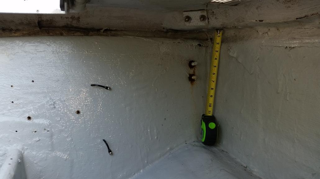

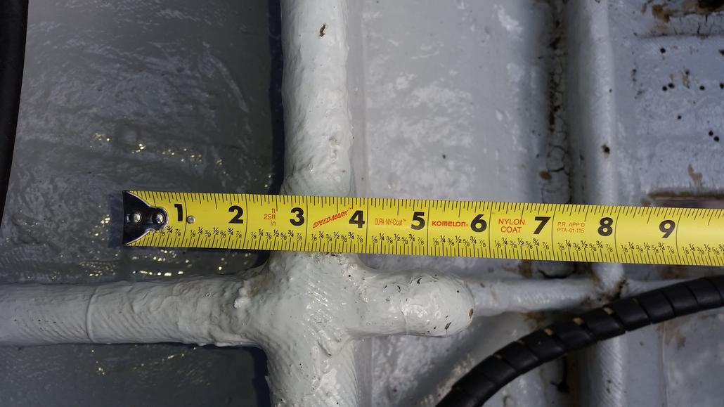

[ATTACH=CONFIG]541501[/ATTACH][ATTACH=CONFIG]541502[/ATTACH][ATTACH=CONFIG]541503[/ATTACH]

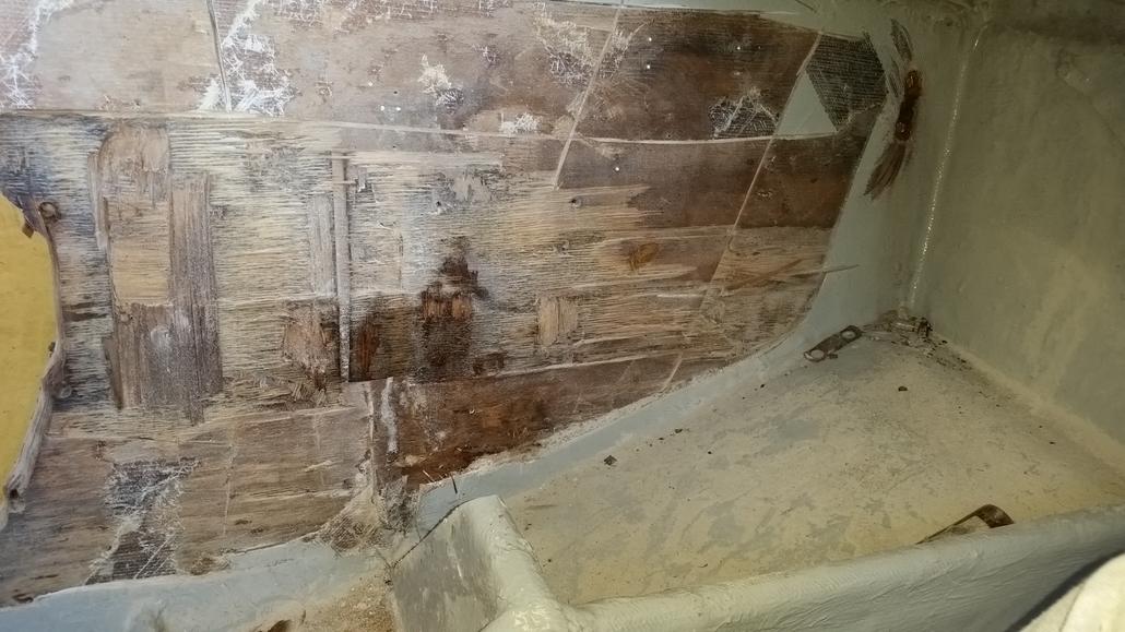

[ATTACH=CONFIG]541504[/ATTACH][ATTACH=CONFIG]541505[/ATTACH]

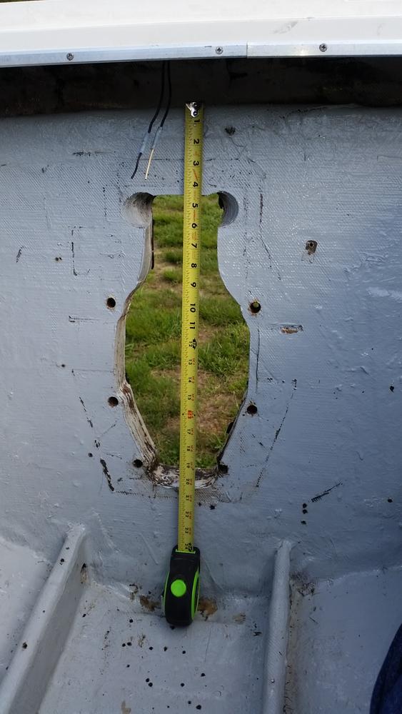

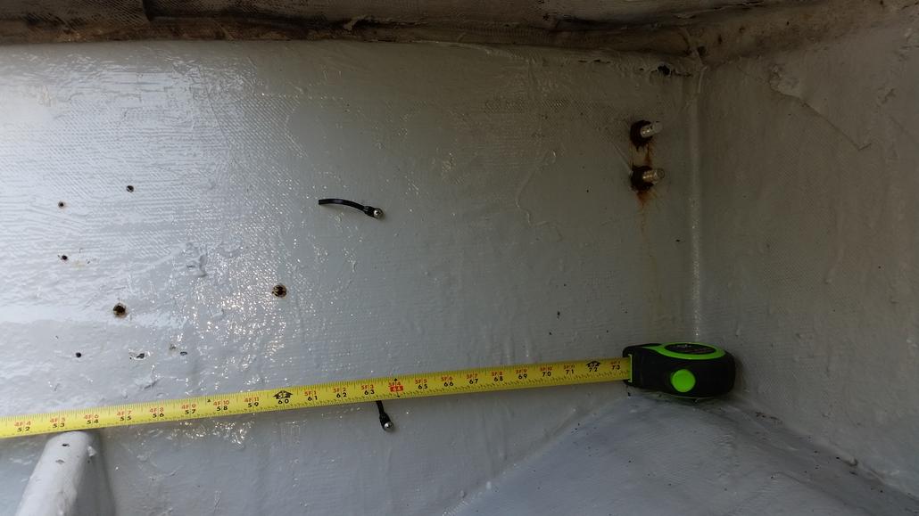

[ATTACH=CONFIG]541506[/ATTACH][ATTACH=CONFIG]541507[/ATTACH][ATTACH=CONFIG]541508[/ATTACH][ATTACH=CONFIG]541509[/ATTACH][ATTACH=CONFIG]541510[/ATTACH]

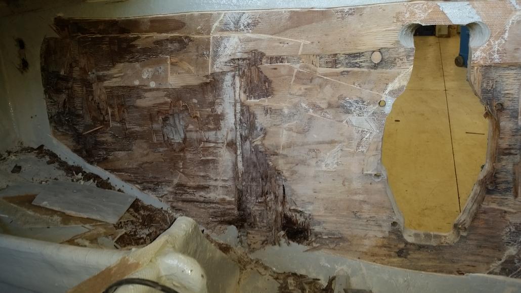

Old 05-28-2015 | 03:32 PM
Joined: Feb 2008
Posts: 560
I wouldnt cut the stringers any more than you need to get the new plywood in. Maybe just cut enough now to get the old out then see how much more you really need when trying to stuff two layers of 3/4 ply in the back of the boat. Good times! start praying now that your stringers are solid.
search for "corebond" in the fiberglass section, its the best way to go for bedding the new transom in

Old 05-29-2015 | 04:59 PM
Joined: May 2013
Posts: 45
From: Hollywood, MD

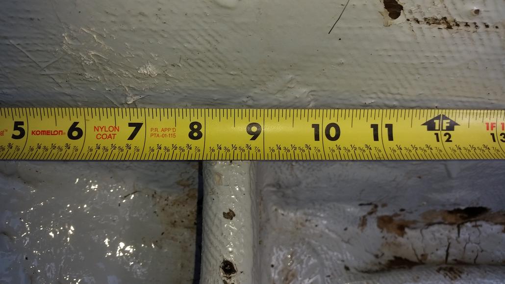

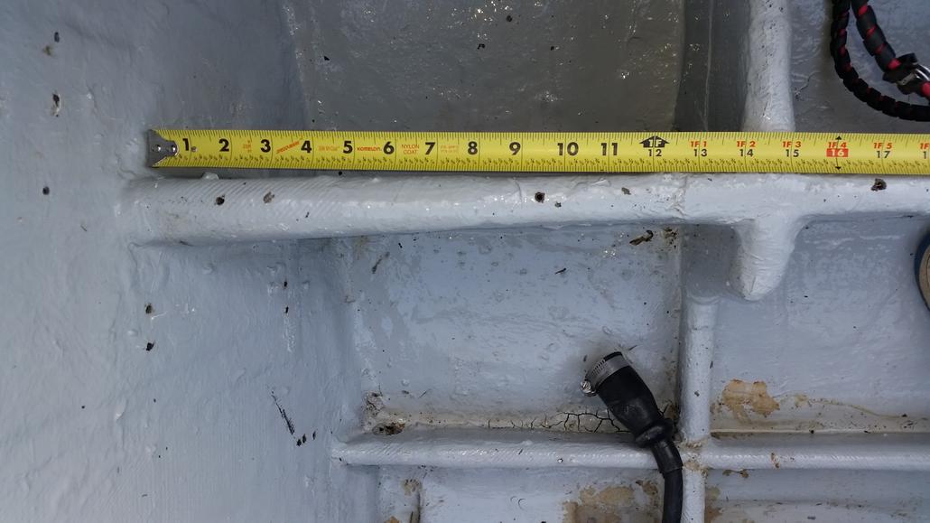

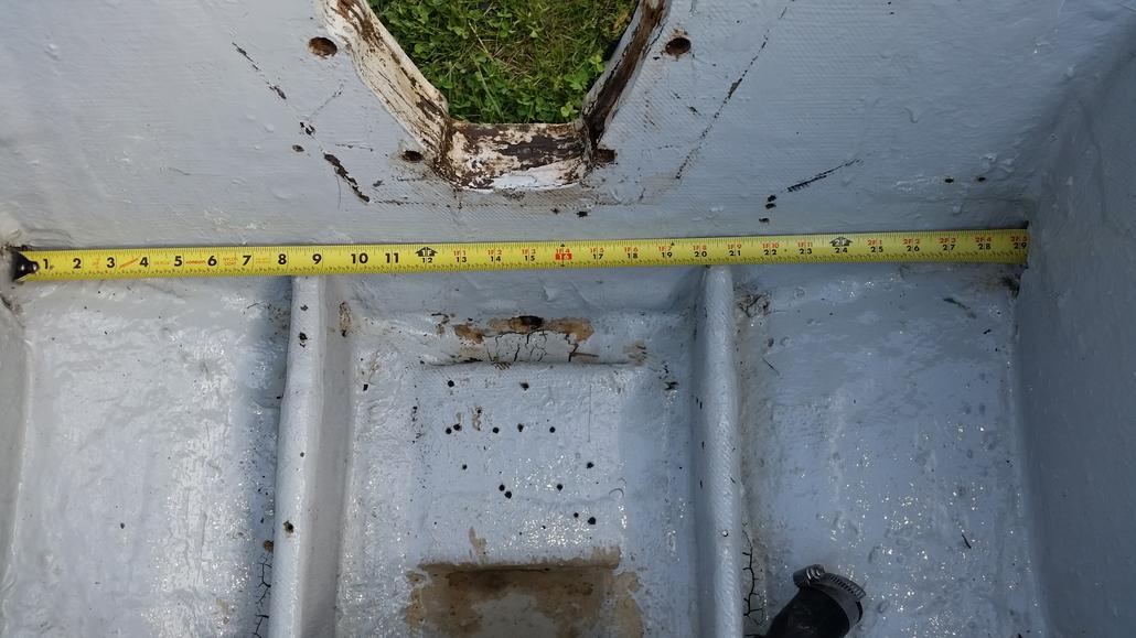

2.5 hours into this project and this is all I got done...[ATTACH=CONFIG]541583[/ATTACH]
TC9ball is offline

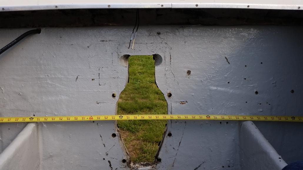

[ATTACH=CONFIG]541584[/ATTACH]

Old 05-29-2015 | 05:04 PM
Joined: May 2013
Posts: 45
From: Hollywood, MD

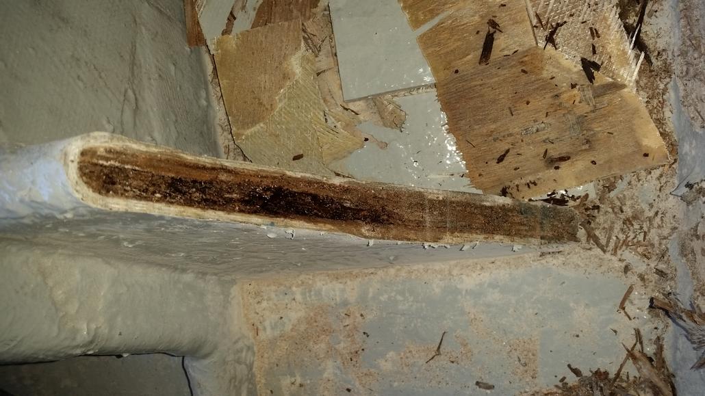

Oh. And I found both stringers rotted
[ATTACH=CONFIG]541586[/ATTACH]
I need a beer! Uggggg
Attached Thumbnails Apache Skout transom-20150529_175142.jpg   Apache Skout transom-20150529_175107.jpg

Old 05-29-2015 | 05:10 PM
Joined: May 2013
Posts: 45
From: Hollywood, MD
