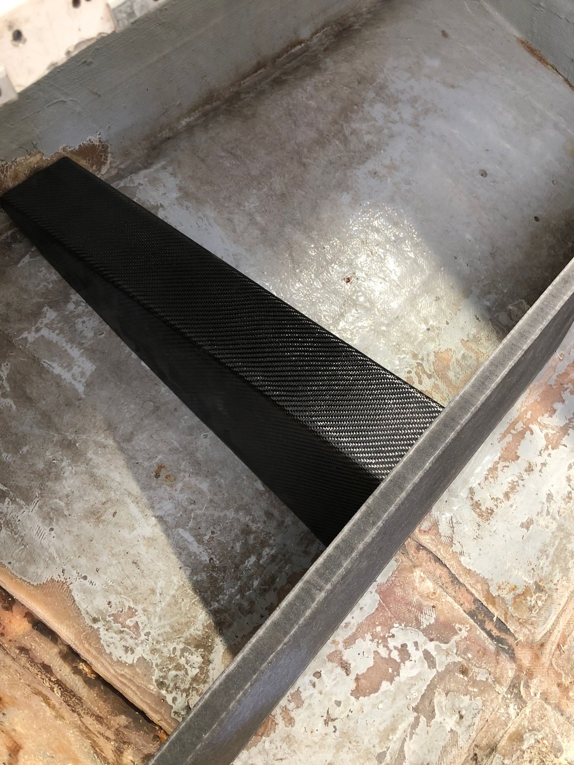

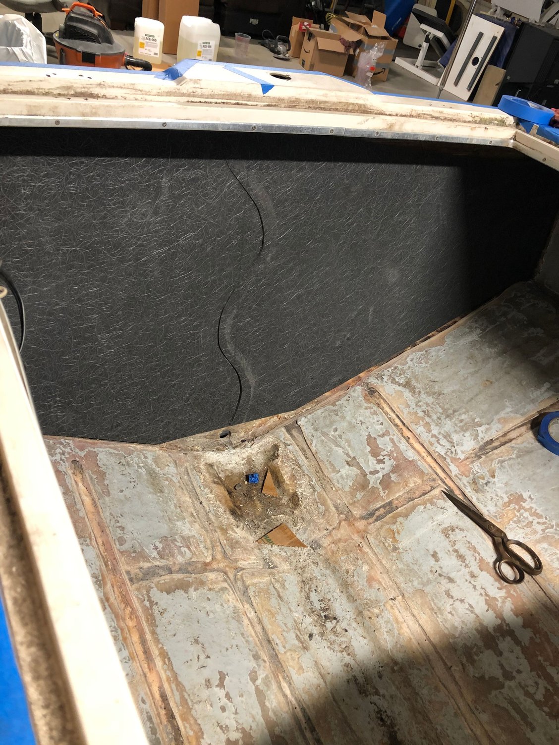

I own it now, It's got a Coosa Transom with 2" wide Coosa Stringers with Carbon Fiber and Kevlar Gussets with Epoxy (No More Wood in the Engine Bay) I've got a 415ci Ls and a Bravo. I'm making a Mold from the 90lb Engine Hatch and will make one thats 20lbs or so with Carbon Fiber.. I still need to measure for Headers..

There is two of those Gussets on each outboard side of the stringers, and two more Plys of Coosa as well..

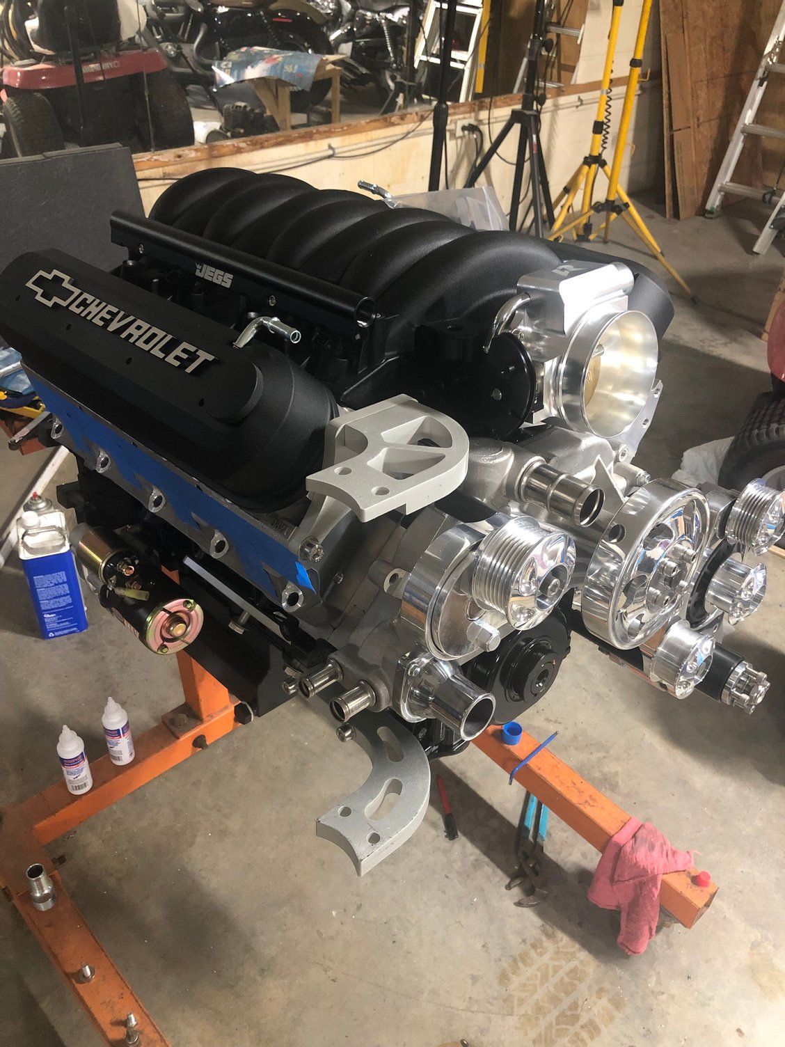

who's pulley system is that ? looks nice
Hardin Marine, I Believe I've Made their Christmas for the Past Two Years.. Lol
Looks like Hardin Marine for the LS. Has the sea water pump below alt.
He don't have the pulley on it.
