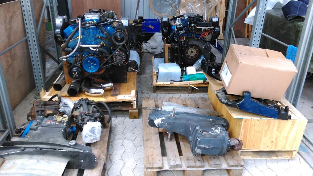

Default All hardware has arrived from us
Now The build up starts NeXT week when boat comes to warehouse..smile
