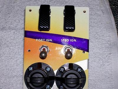

To all fellow Awesome owners. For whatever reason, and please correct me if I am wrong, (with one exception) our boat were built without a ignition kill tether system. The key switch was the only way to stop the motor/motors from running.
For safety sake, (for those who have not already installed one)would you please this winter consider installing a tether system on your boat. The cost is not high and think of the safety element that you have put in place.
From a personal experience (not with my Awesome but with my previous boat), I was throw, cleared the boat so no injuries to me at 65+ mph. Was wearing a full vest. I was the only person onboard and the boat came to safe and short distance stop. I was in Lake Erie at the time, nuff said. The tether saved my butt.
I have a considerable amount of electrical expertise and can help anyone who may need it to install this system.
The pics show my ignition/start panel. The upper momentary military spec switches are for the starters. The middle military spec switches are for the ignition on/off. They lock in the up "ignition on" position and the toggle handle must be pulled to place back into the lower "ignition off" position. The lower is the Merc tethers.
