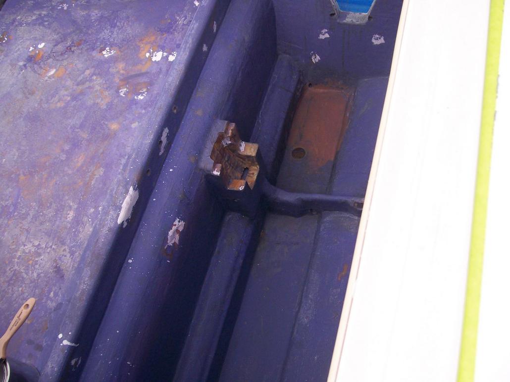

Well, this project is finally moving forward. The engine compartment was a mess. Little organization and that bad purple paint meant only one thing------start from a blank sheet. First pics are the "before" painting. The before included some filler to cover many holes that will not be used. Huge amount of sanding was in order too. And I mean hours upon hours. Everything was removed. Eventually the hydro steering hoses too.

The original motors were mounted on wood platforms grafted to the side of the tunnel as pictured. The wood platform served as a mounting base for standard merc style engine mounts.
Out comes the grinder and large portion of the platform was trimmed away to clearance the new offshore motor mounts. Mounted to the stringers, thank you.
The trim pumps previously were mounted on the tunnel floor. They are now going to be mounted to an aluminum transom plate. I am designing this to have a clear tunnel floor. Custom floor panel is in the works. ;-)
