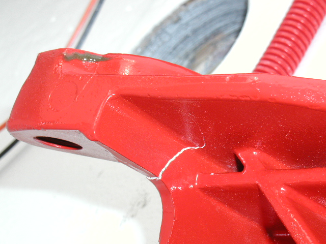

putting the boat back together after painting (graphics will come later) ran into a little problem, installing the p/s unit, I cracked the transom plate. Can I or should I try to weld it, or should it be replaced. Does anybody have a used one for sale I can buy.

thats ok, i powder coated that one. I have some one that might be able to weld it, but he needs to look at it first. How much do you want for your if this one cant be welded.

I guess it's just me, but that is one part that I personally would not put my trust in if repaired. Go for a good part.

Don't Weld. Buy A New One.
