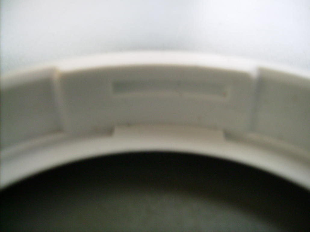

Yes,
They had two styles for the Teleflex/Livorsi unit. A thin style that is easy two break while installing, and this thicker style that teleflex used in white, or chrome. You need to look at the inside snap indentations and line them up to the depthfinder unit, because they are slightly different from one side to the other. Not lining these slots correctly is what usually caused the thin style to break.
