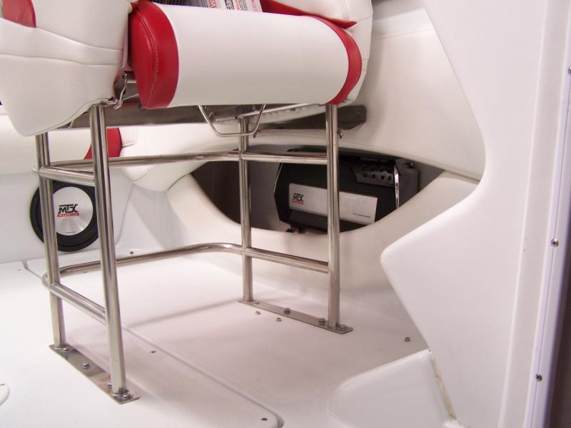

Looking for suggestions on where to mount a stereo amp on a 1999 25 outlaw. I was thinking about placing it under the back seat, but was worried about it getting beat up from the stored equipment.
I had one under may rear seat at first, but it got wet and eventuality failed. I have three now and they are all mounted on the wall of the cabinet down inside the cabin. Have not had any trouble out of them since. You can put an amp down there and its easier because it is closer to the batteries. I have seen several overheat when mounted under there because there is very little air flow. If you drive the amp hard it may get hot and trip the thermal protection system from time to time.I installed 2 amps in my neighbours 242 back there and they are still running fine, but they do get hot and cut out when he cranks it up for long periods. Hope this helps!
I think if you could put cooling fans, or a vent to get fresh air in there, it would be ok, but all the ones I have seen or installed under there have the problem. If you put in an amp so large that it didn't have to work very hard that would probably help as well. In my first boat, I had two amps mounted in the engine room on the bulkhead and they ran ok as well. The way they are now (in the cabin) I never have a problem with them.
There is a pad built into the forward portion of the back seat bottom on my 29. That is where my factory amp was installed.
I installed my 2 new amps in the storage compartments in the cockpit sides. They look neat there, but I think if I had it to do over again I would mount them in the lockers in the cabin.

Thanks for the information guys! I hadn't considered the air flow issues. Jason - have you had any heating issues with your amps mounted in the side compartments? I'm assuming you are talking about the compartments on each side of the boat beside the bolster seats?
