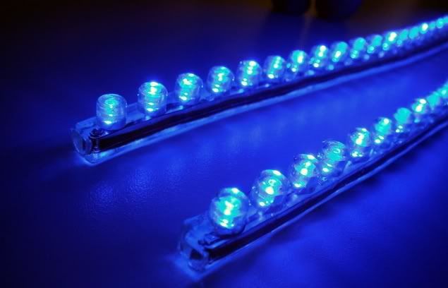

In the photos they're running off my 12v battery pack.
I'm thinking of hooking them up to the wiring for the stern light (white mast light). I don't really see a point in running more wire and adding another switch.
They were supplied with a 15A fuse.

They look Great! What holds them into the aluminum channel? Are they glued or just floating in there?

They're just siliconed in place inside a small aluminum C-channel. Not much to them really, I think the guy is making some good $$$.
It would be interesting to see how bright those Ebay ones are.
Check out these links: http://www.ebay.com/itm/2-BLUE-LED-S...item41697321f2
http://www.ebay.com/itm/120cm-Flexib...item4a990e1cd1
These look identical to the ones that are installed in mine. Sort of rubbery/PVC bulb-like.
LOL - $10 for 120cm..... Would make about 4 sets. I'm guessing these are cuttable as well.

Any advice on placement of the transom lights? I have two of the larger coastal night lights arriving tomorrow. Was thing of installing the level with the trim tabs and placing the smaller one just above the drive or possibly underneath the swim platform on my h2x. Any ideas? I was thinking I could run the wires through the trim tab holes if I mounted them close to cut back on drilling through the transom. I'm expecting a dramatic effect since the two lights are 760 lumens and the smaller on is 400 should leave a nice blue streak after dark! Any input is appreciated

Sounds decent. Think about the waterline and where exactly you want to illuminate. You can still run the wires through the trim trab hose holes if you wanted.
I did wire mine into the stern light...... Works great.
