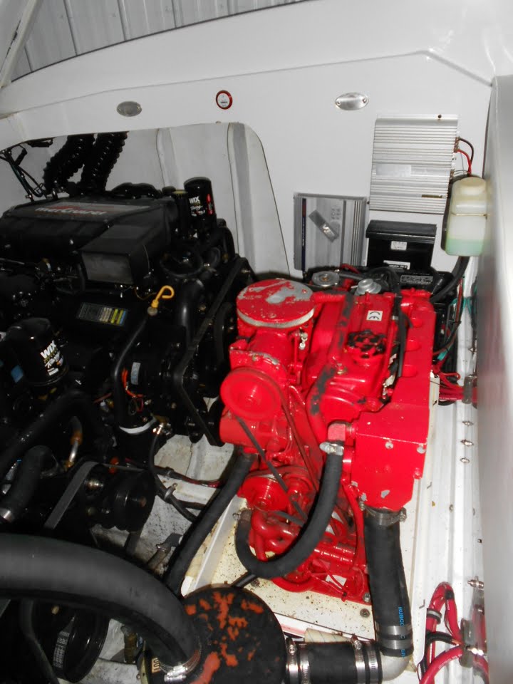

Disconnect the water line at the strainer or even at the inlet on the genset itself. Connect a longer piece of hose to reach a bucket of 50/50 in your cockpit. Don't have to go all the way to the bottom of the hull at the sea cock. Wife fires up the genset and right before the the bucket gets drained - fog it and kill it.
Of course it's easy for me to say when I have this much room to do it all.

I don't know how long you have before the impeller burns up. It's strong, but if it has to travel very far, I'd try to prime it somehow. Maybe a submersible garden pump?
