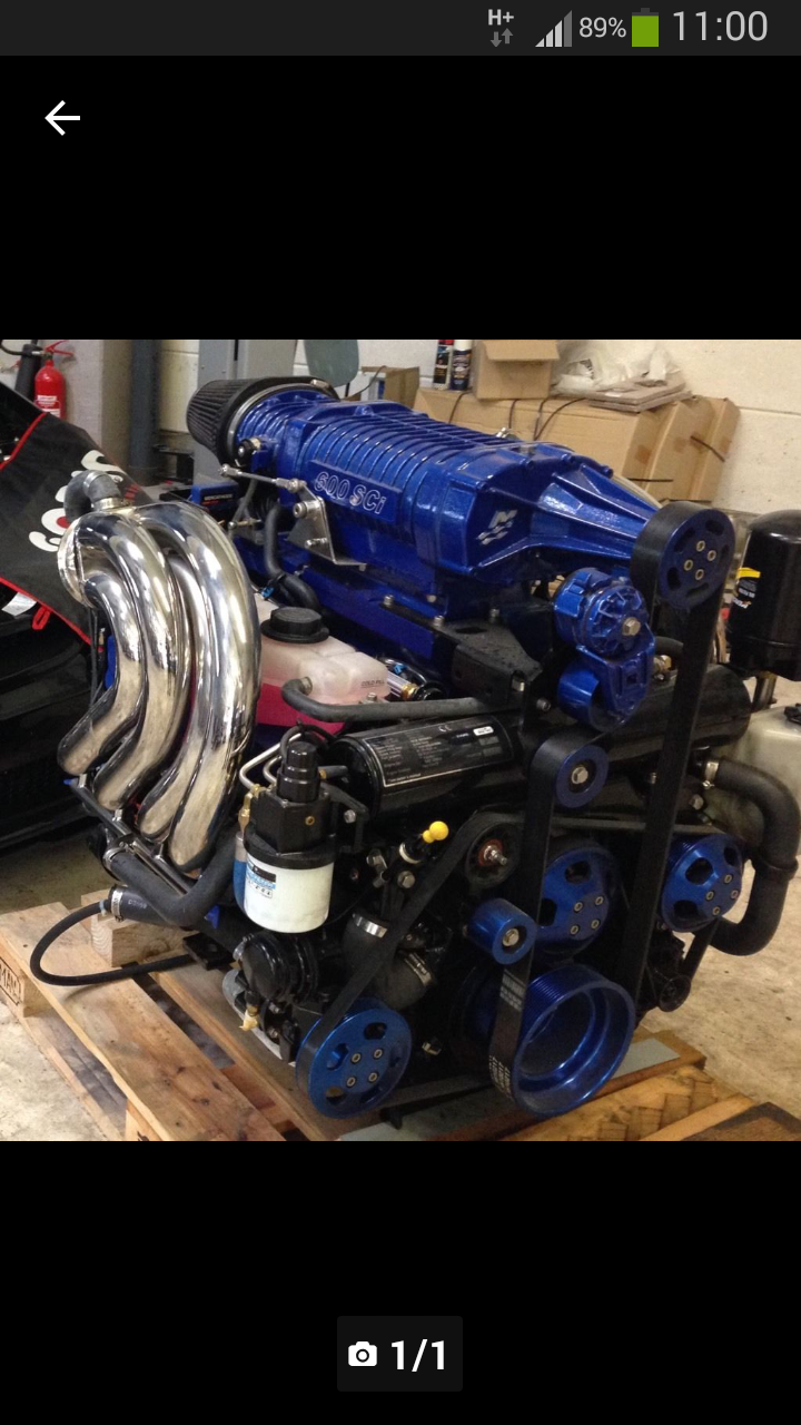

Yes the 700 and 600 are very similar. I believe cam, intercooler and evening are the only differences. And if you talk to many who have worked with theses motors they’ll say the stock valve train is questionable at best in these motors. There were a run of the rockers that went into these motors that fell apart, dropping needle bearings etc everywhere. Not trying to scare you or get you worried, just sharing some things I’ve found through my research. If it were me I would change the springs, stock replacement should be fine, and I would replace the rockers as well. Much easier to do these things before she goes in the boat.
Either way way that’s a cool motor you got and that’ll be a fun ride! Looking forward to watching your progress.

Hello.
I am happy about all infos like this about the rockers.I am one of the safe drivers that try to do all that get no fault at driving.Can say i have all sensors,starter,lightmaschine,boostvalve and much more,maybe all electric parts from the engine in my boat!!!
Also have buy orginal connectors from the IAC vent and build an wireparts with 1A Fuse to stick between as i read there is a problem.When IAC fault,it kills often the PCM.Must buy 15 connectors in and 15 out,so if someone needs this wires with fuse and orginal connectors,get back to me. i have build some sets.
Also i have checked long time the diffrences between 600/662/700 SCi.
Only the first series 600 SCi up to engine nummber 0M962885 has a 10mm lower intercooler.All 600 after this nummber have all same intercooler like 662 and 700sci..But the older 600sci have same power options,as this aford it not real.I have ask what makes an update from intercoolers,as the newer will fit,but all say makes nothing.
best ist to look for more waterflow in every from this inercoolers.(i work on this).
For example 662 has only other software and an other pulley on the supercharger! Not more.I have ched partlist long time!!
So only first serien from 600sci have 20mm shorter belt for the charger(10mm lower so 2x 10mm shorter belt!
My engine was build 2008 ,first series 600sci,but get end 2010 complet new longblock and headers from merc in warranty(cmi old series crack and kill the engine in the warranty time).first they mount new lonblock with new old cmi series,but before 10 hours they change again the cmi for new version.
In this condition the engine stand now 7 years iconserved and winteringsized in warm shop.
an idea how i can look if i have this bad rockers now?? the have only run 50 hours and made 2010.
best regards.
michael

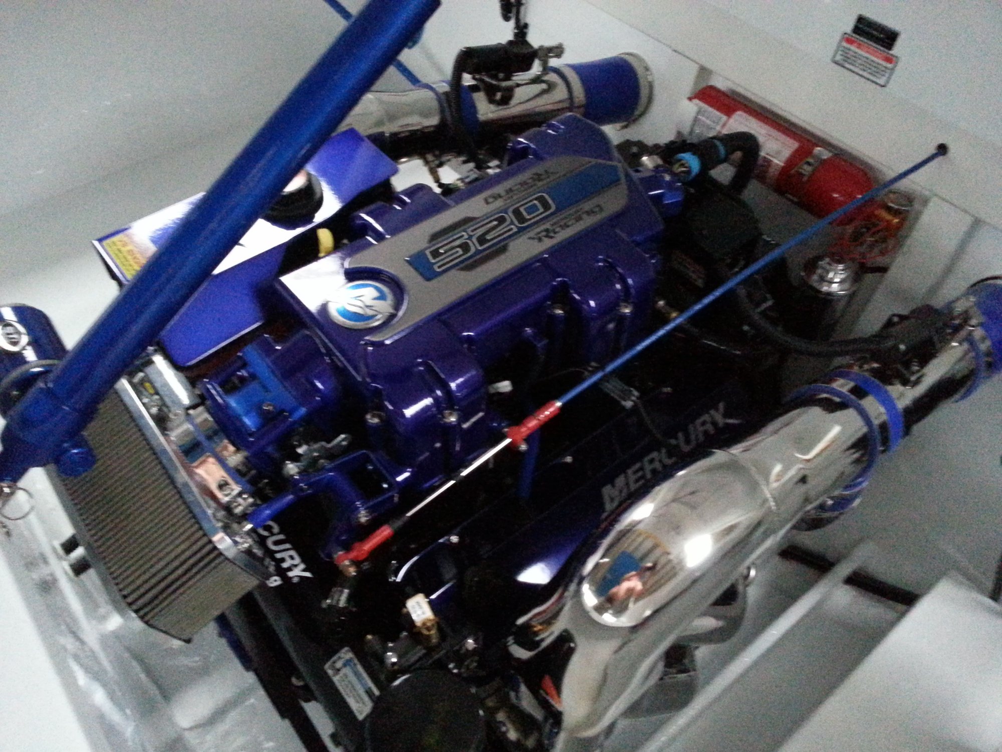

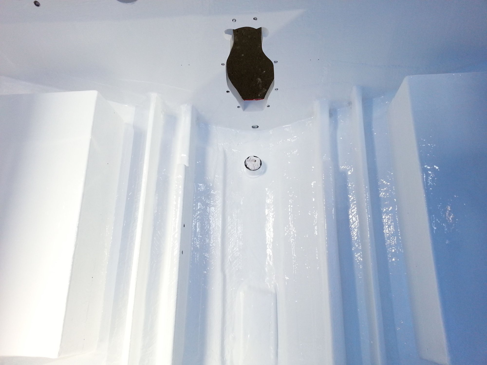

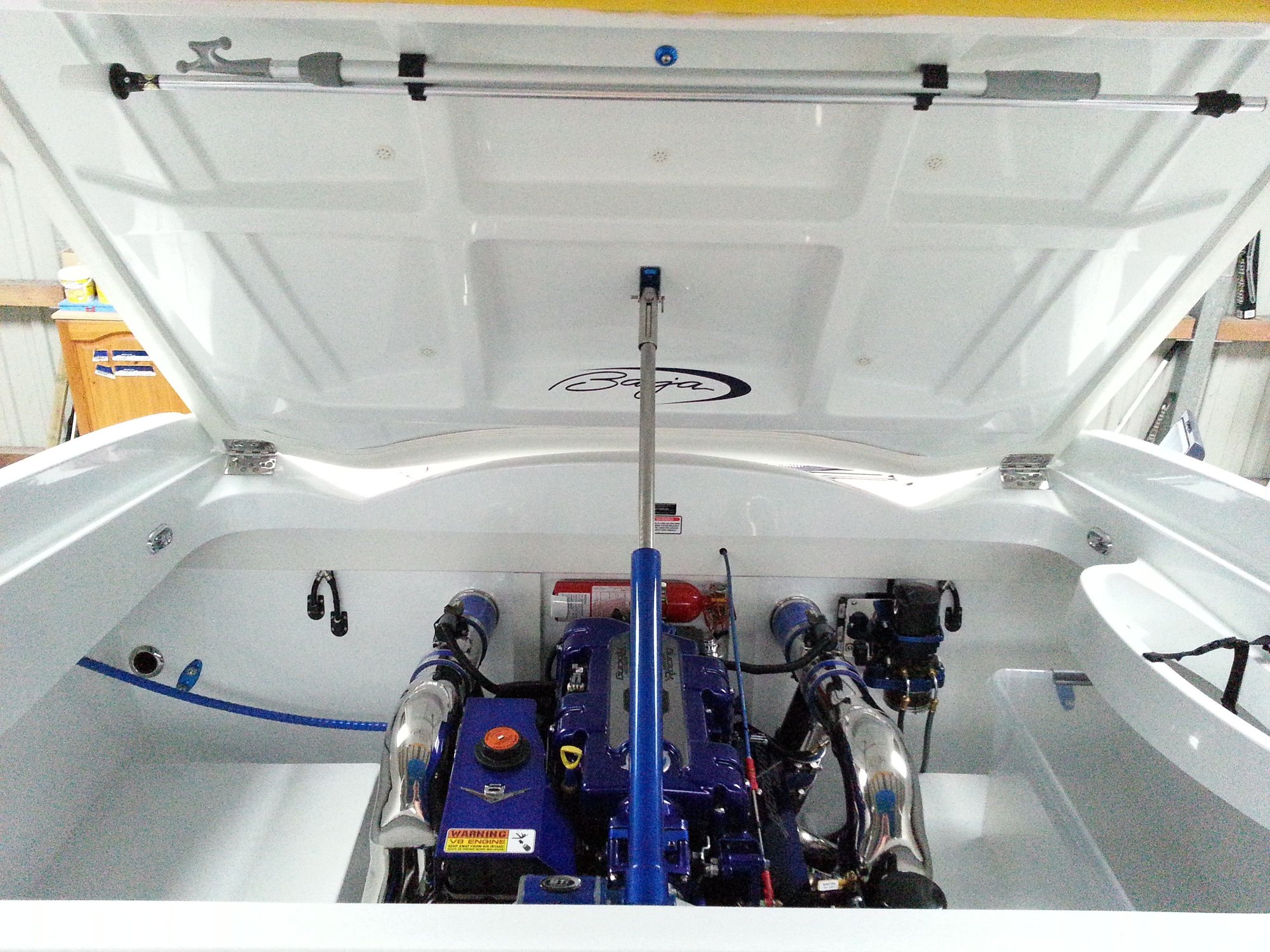

Here is the buddy and pics from old engine!As you can see i like the clean style.Pics is with full working engine and boat.all hide like i love it.Airblower and shift linkage in the plattform.behind plastic canal for all wires and gas cable and so on.
I get this 275 near new with 49 hours on 496 Ho but the work from Baja to install all technic was extrem poor.I like it im my way much more.

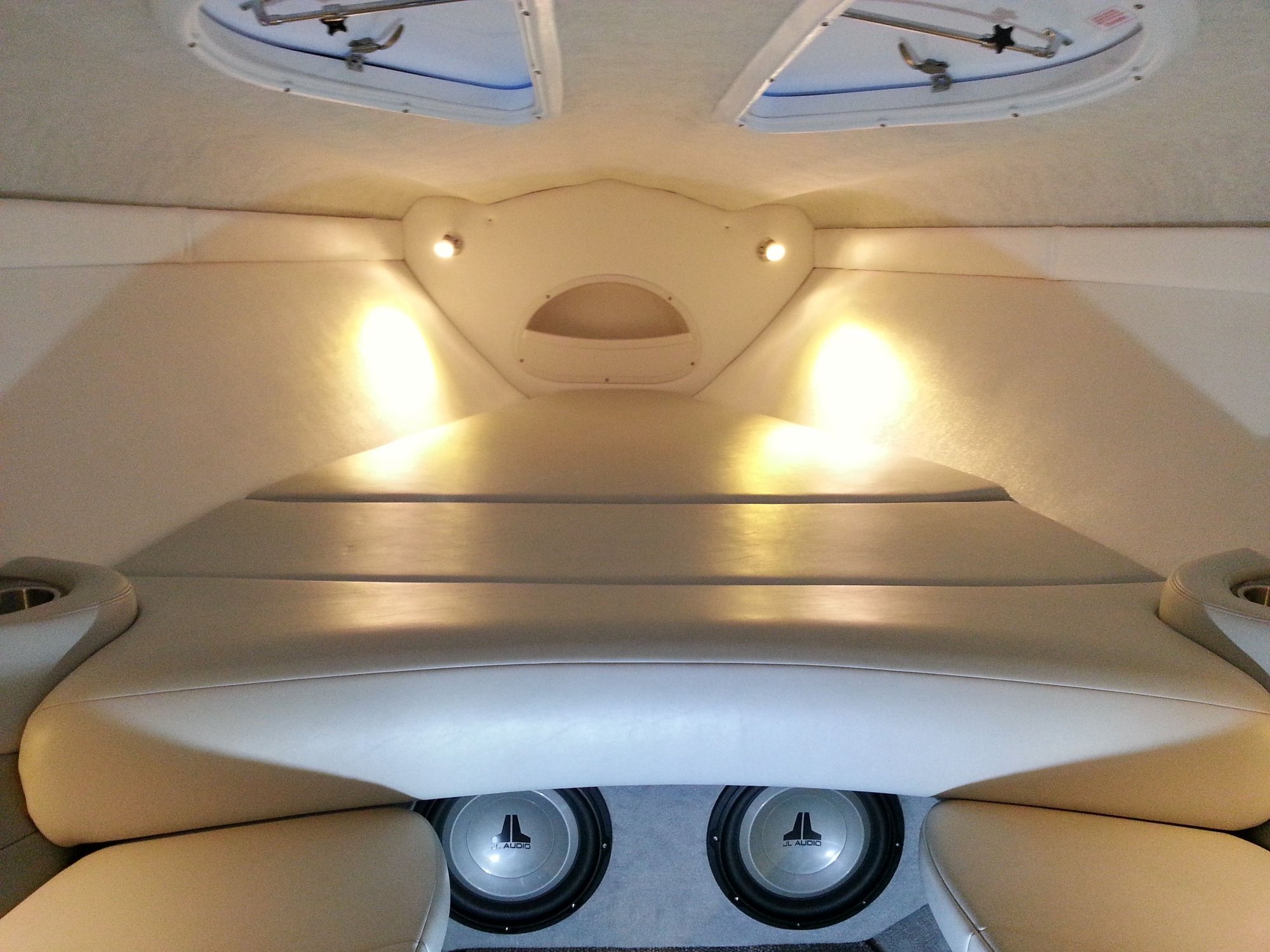

Here some more pics from the boat! I get it end 2016 in 100% standart like it come from baja.All changes made by me!When engine runs,i like to add hydraulic steerind,maybe ITS and then some more things like big tabs and so!
A boat never real ready!!
Changes 2016/2017:
New Carbonplates for Gauges(smartcraft Gaffrig) switches and so
JL Speakers and Amplifier
Kenwoodmarineradio
Blue bezel at clams,grips and all i can do them
new harness 14 pin smartcraft and all other electric new and so that you see it not in the engine room
bilge and trimtab pump behind see side,so unseen
batterys in the rear seat
and to mayn small changes that can not liszt here like unseen maiswitch for battery.maybe i load some pics more here if wanted!?
Michael
Changes 2016/2017:
Kenwoodmarineradio

Very nice! Sure is clean back there. Looks like a mercury 540 intake on the 496?
Edit: I see you mentioned you put one of the new 8.2s in there. Oh, and are we tanning topless on the sunpad?
Joined: Dec 2013
Posts: 408
From: Germany
Yeah i build a good replica from an 520 with my 8.2!! Runs very good with biggest Whipple PCM update and CMI.I see 73 Mls best on the Ecomonitor with added GPS.

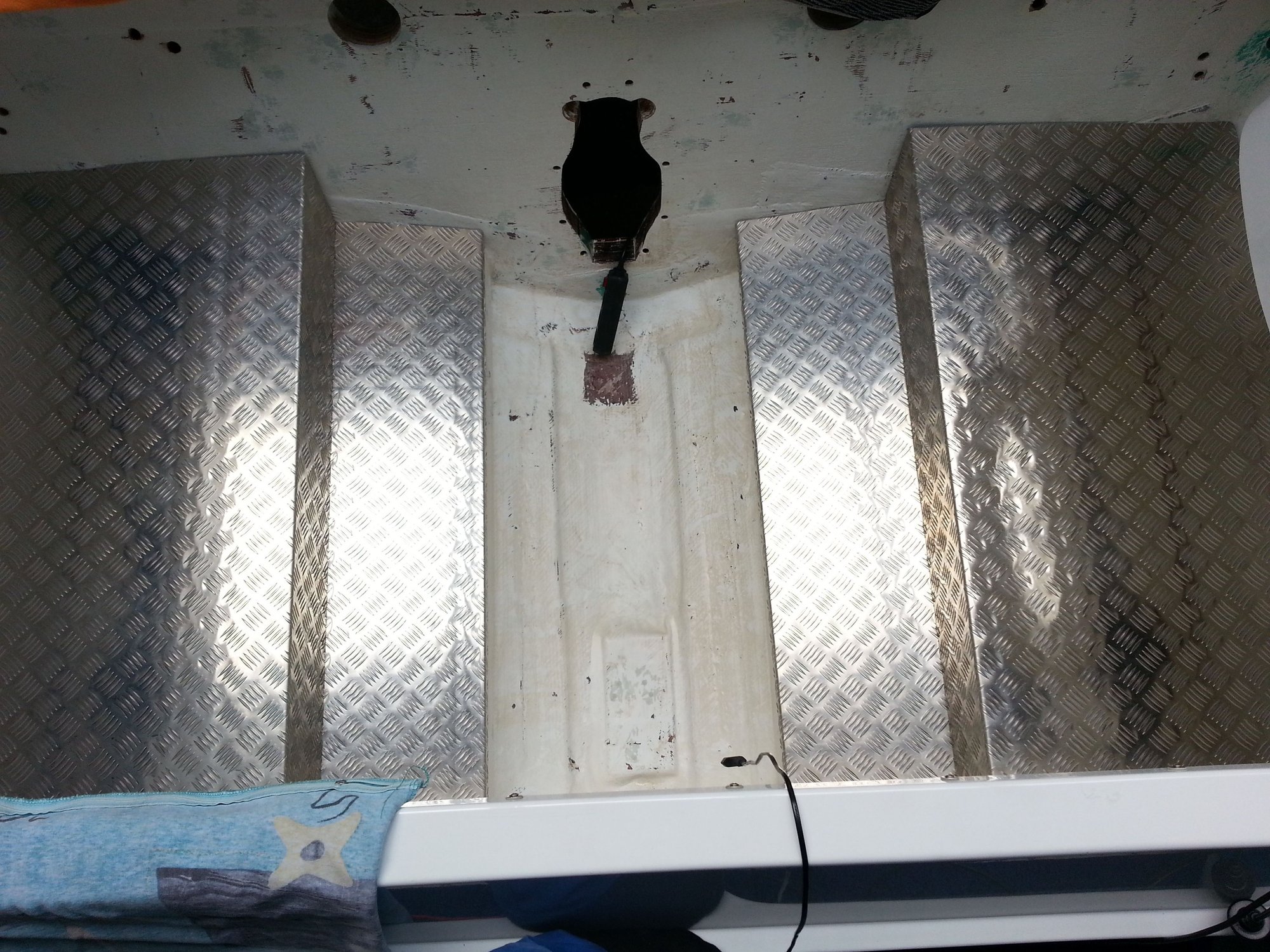

The 496 was first that gone after buy the boat.Then clean engineroom,close all holes and so!I make some alloy plates fitting,but mount not last winter as i want the powerdecoat first and then make in!
Michael
