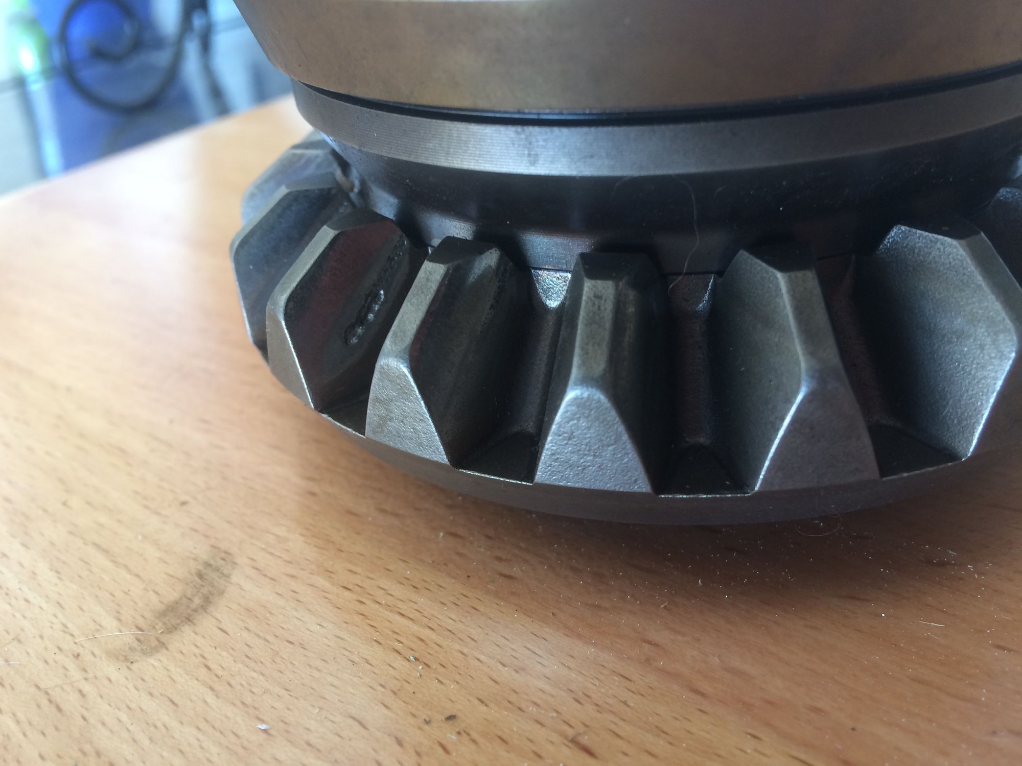

I use the 600 SCi with an XR on my 275 ,but i have add an Driveguardian,that takes much stress from the Drive!
I think it is a good tool after searching about DG!
I mean new 600SCi come allways with ITS and -2 Sportmaster XR!

The drives break not about HP. The torq pikes when prop comes out of water kill them!This is 2-3times more than the engine produce!
I was real wonderimg that not everybody,no matter if use Xr or Imcos,use the DG!??
This part is an inovation and can save extrem much money.Michael

I habe opend my new 2018 XR now, and see no signs of wear after near 70 Hours behind the SCi! I use the Mercury Racing gearoil 85W90 that has clear colour and look near like new filled in.
I belive my XR with DG will last many years and also gurantee to 2020!
By the way,i pay 4000 dollar for the new XR,as it was one with XR Diesel and seacore decal!
I know about trouble with overpowered XR and so i order the DG as now i can Not easy update my engine!! Was an inshurance for me as if i have it not,i will make more and more power at the motor ,like most guys here.
With DG is now much work and trouble to update! Engine out,send DG to Usa from germany and adjust new and so on.
So I better use the package like it is and be safe.
When want more than 600 HP i would also go with other drives or update my XR with teage parts maybe.
