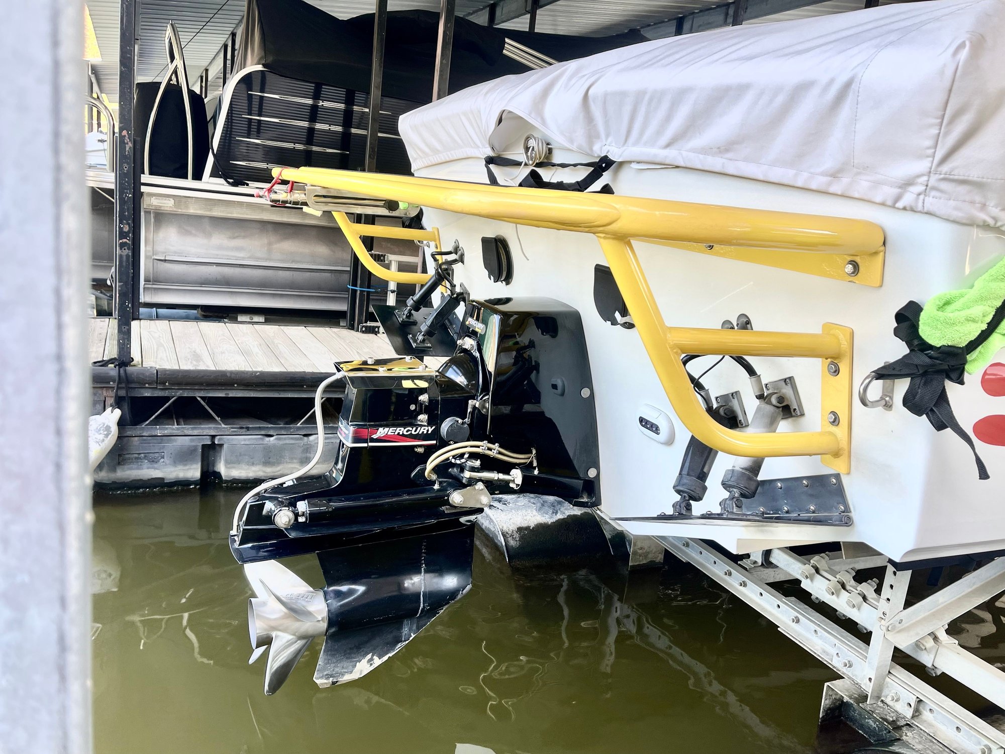

I installed the IMCO Uni Mount myself and twin rams on my 292 last fall. Not cheap. Worth EVERY penny. Made it a whole new boat. Now instead of fearing for my life and having over 40 degrees of free play at the wheel, and getting exhausted after a 30 min drive. It tracks wherever you put the wheel and holds course like a luxury car on the highway.

Old 11-12-2021 | 03:38 PM
Joined: Sep 2021
Posts: 19
Also is tha a mouring cover how’s the figment I’m looking for one that covers the entire boat etc
