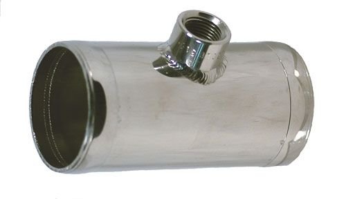

Most likely you will not have an extra port to install your fuel return line into the tank. Easiest way around this is to install a T fitting in your fuel fill hose close to the tank and run the return line to the T fitting.

Many peep’s use these , or similar, for returns.
https://www.cpperformance.com/c-500-...s-returns.aspx
