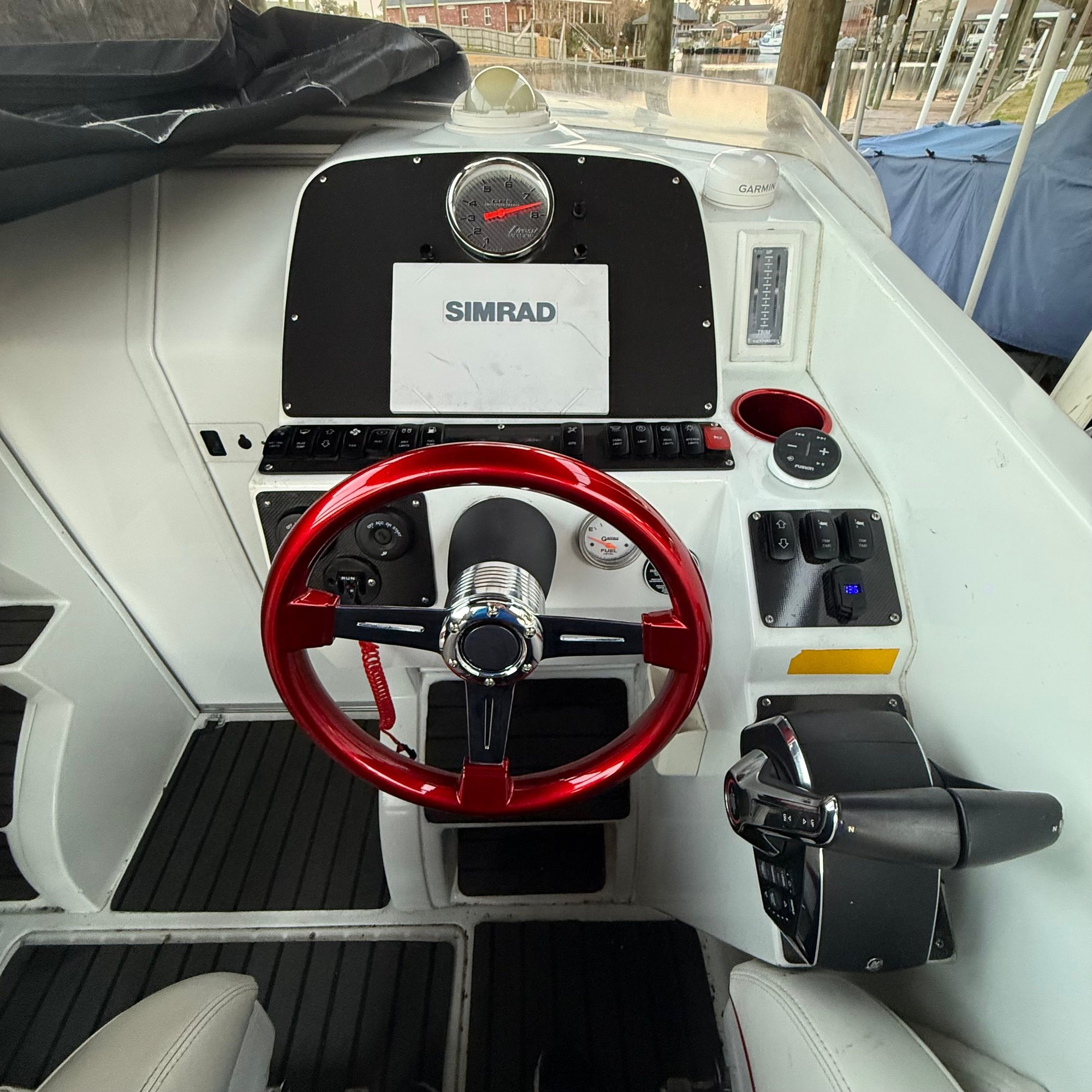

Black buttons came out good.. Just waiting on new red/chrome steering wheel it be delivered!

Finally warmed up to take cover off and install my new wheel..
I think this about wrapped it up folks. other than doing something with the faded compass i never used!

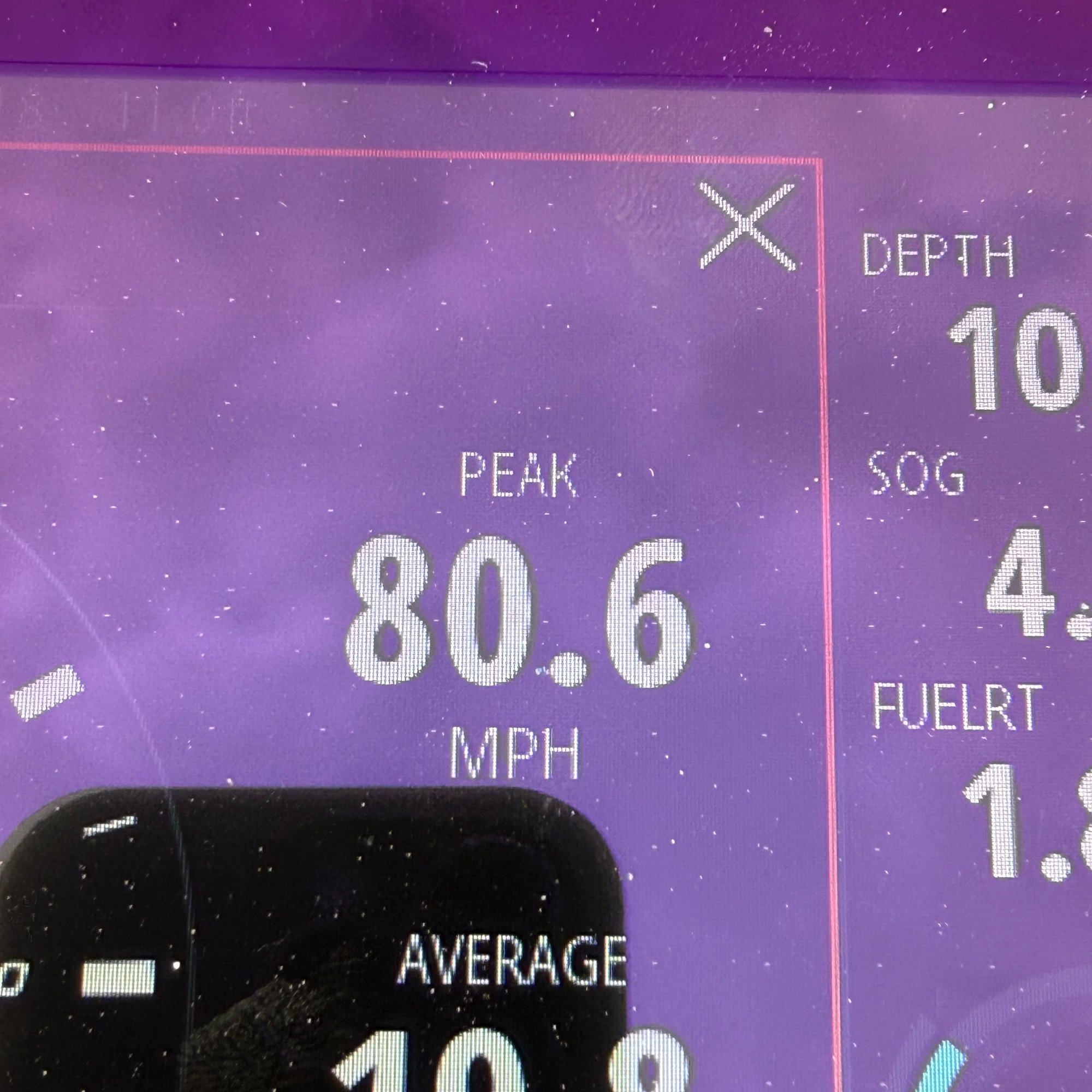

Updating thread.
- Hull blueprinted to remove hook and sharpen transom edges.
- Stock 23p Rev4 Xp’s to 26p B1’s labbed by Bblades
120 gallons, 1.5-2ft chop with 11mph winds and 66 degrees and myself.
Prev best was 78.7 and NOW 80.6, but need more testing!
