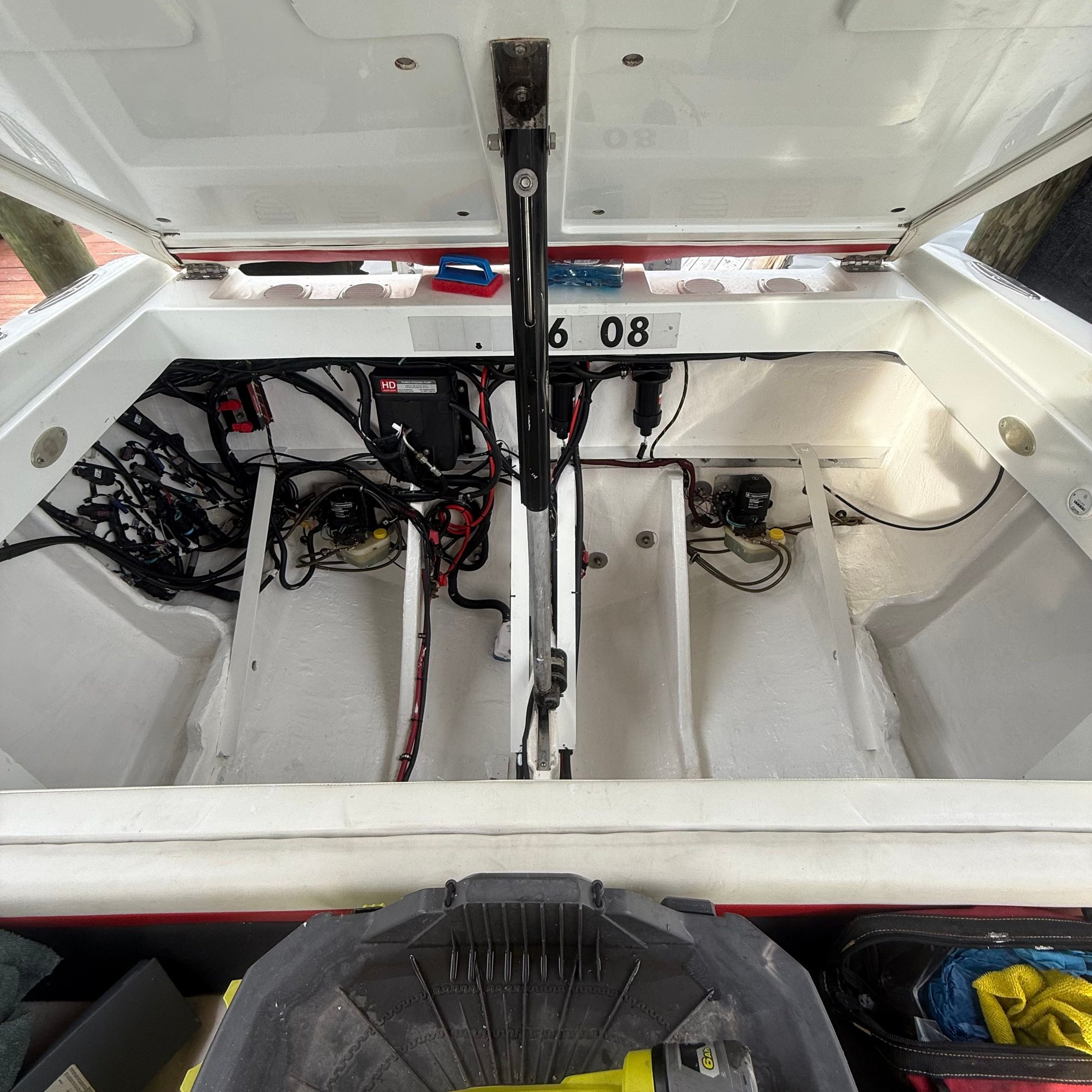

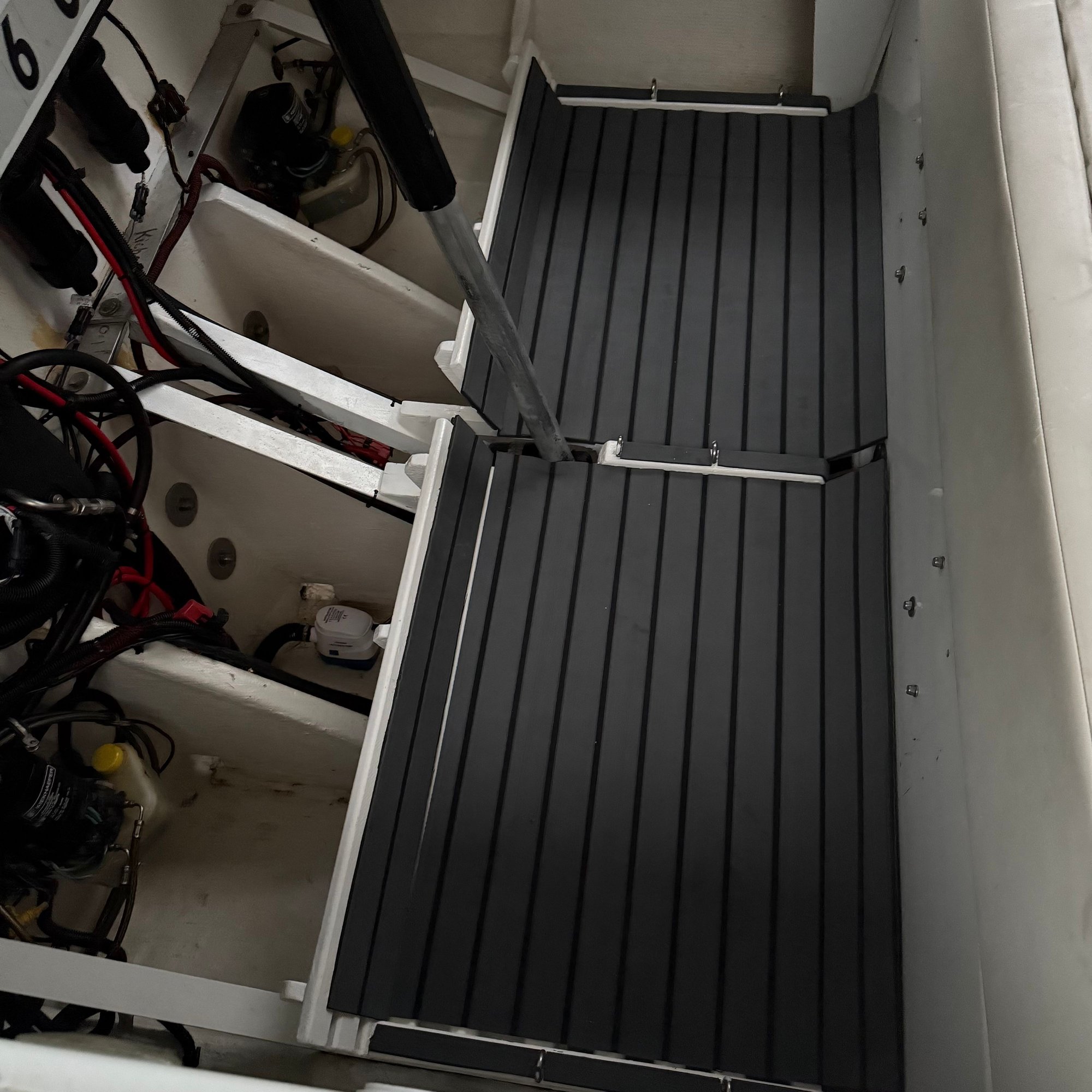

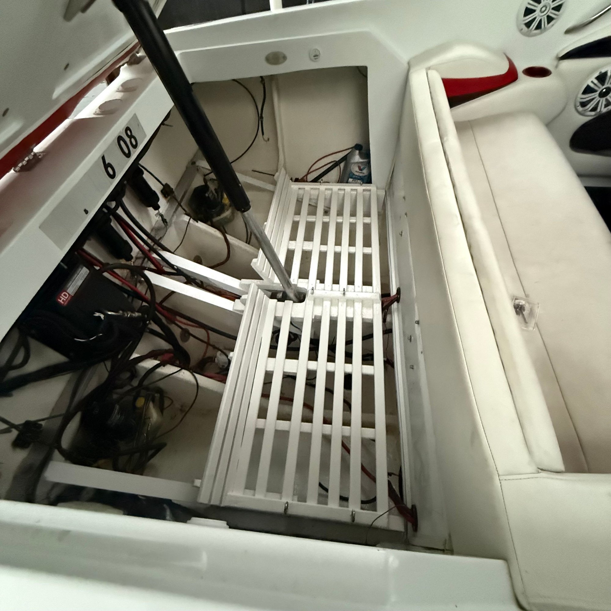

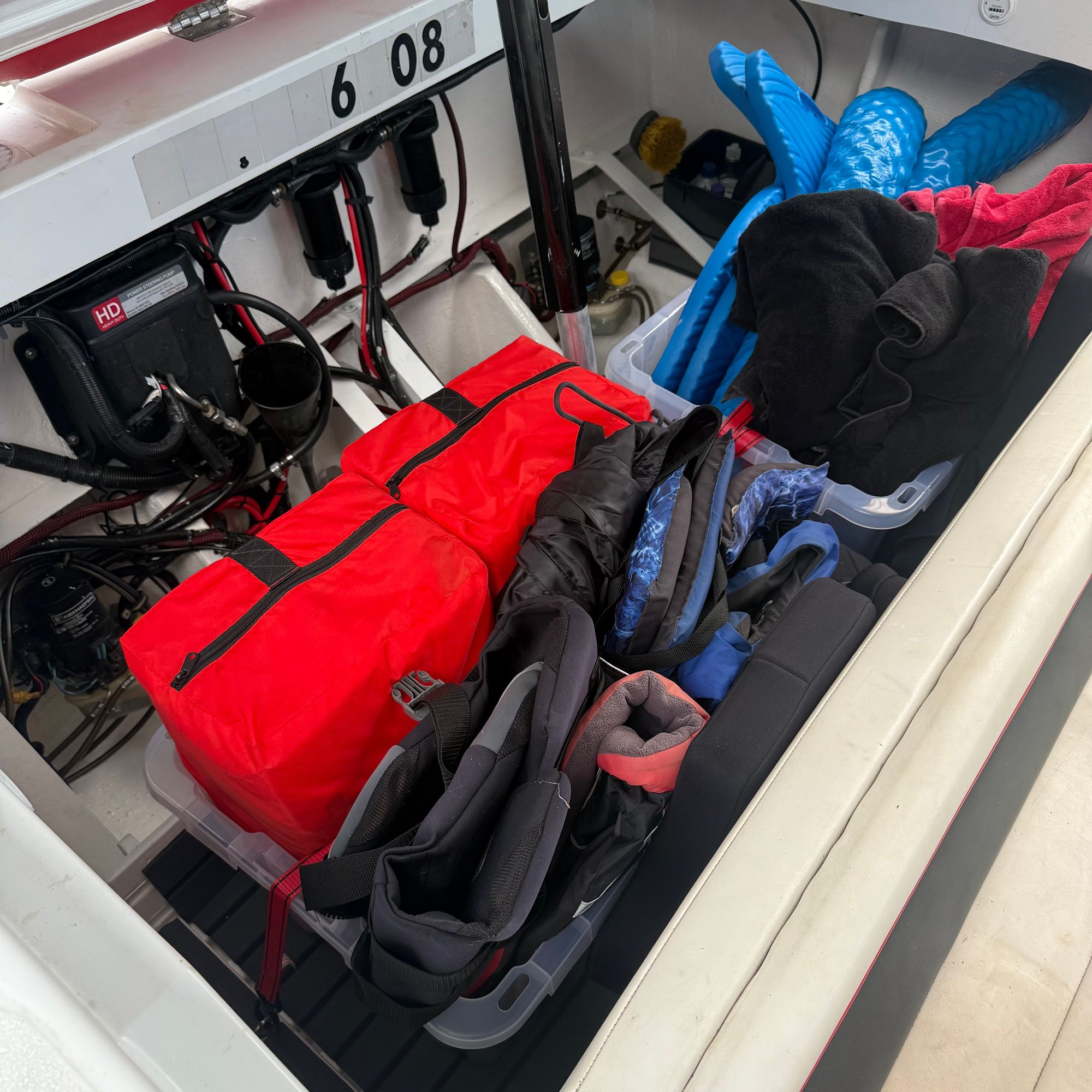

Finally got the wiring tied up. Also built a removal storage rack so I can clean out to cuddy.
I strapped down 2 large bins and strapped them down. Anchors are now in gunnel area and the rest of the motor monkeys, couple rafts, and towels are in the bins.
Probably pulled 200lbs out the bow!

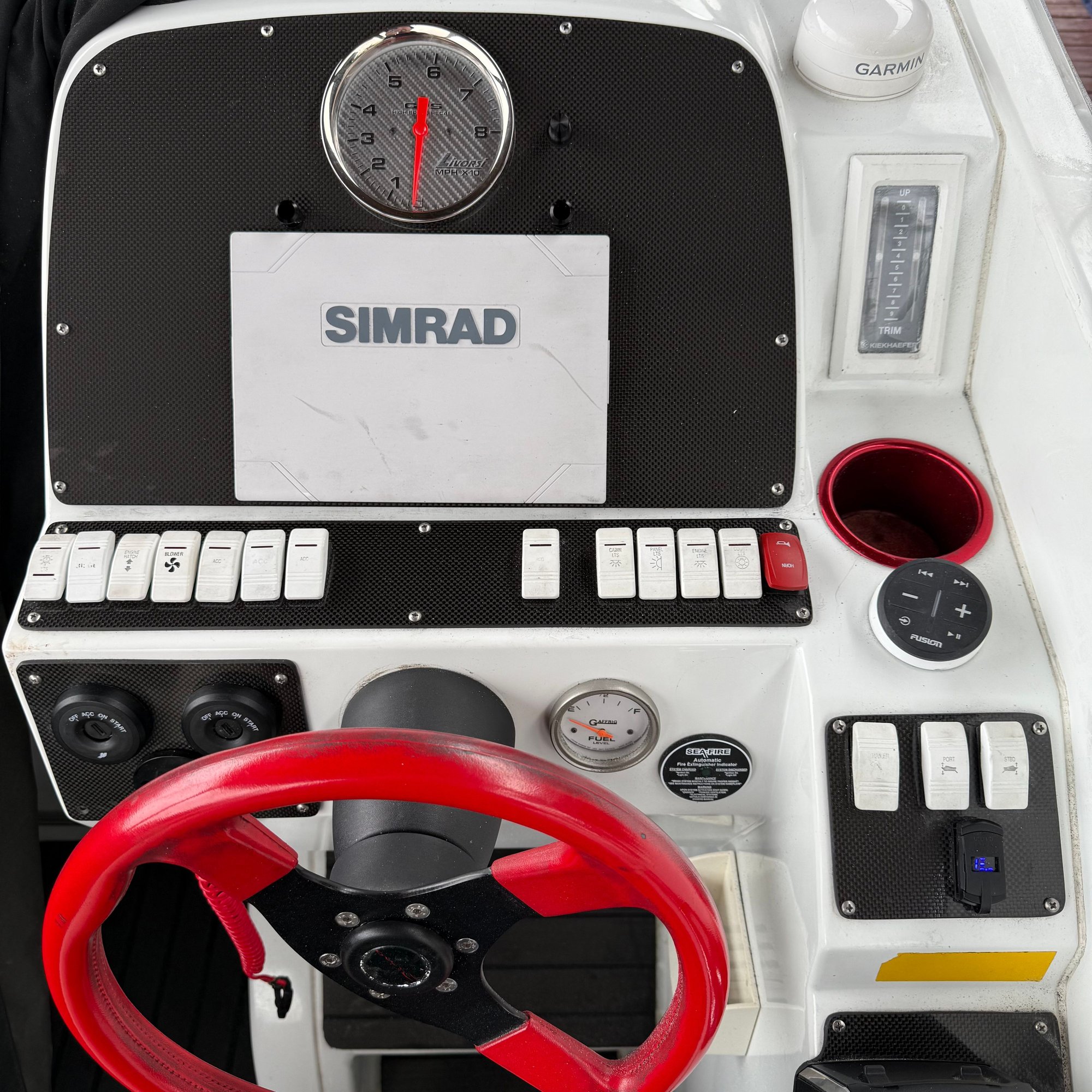

Finally got around to doing my other dash panels in carbon fiber. Ordered black replacment switch covers. Also swapped out my Lowrance and put my GPS Speedo back on.. Dial is much easier to read at speed (and my aging eyeballs lol)
Also tried to hit 80 in this cold weather.. Well…. I was running 6250-6300 in summer and now running over 6400…. But rev limit slows me back down, so I guess I need a lil more pitch or cup, but definitely doable!! Could pull 6450 before is put the brakes on me. O/b rev limit is definitely softer than the old Mercruisers!
I think I need to update the steering wheel next. Not sure what I want though.. but probable Red as it seems to pop.
Also, look below the trim tab buttons.. thats a cell phone charge in the shape of a rocker switch w/ digital voltage display.

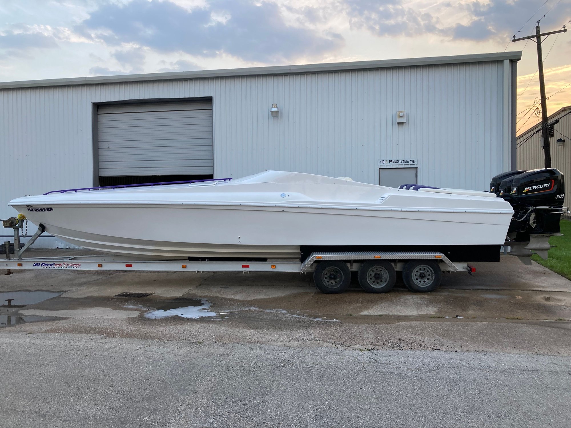

boat turned out nice
hope to run into u at tickfaw this year or at the races by new orleans as ill be at both
here is pics of my 32 hustler i restored and converted to triple 300s
lot lighter hull that was fast in the classes back in the day
so it cruises 75-85 and goes past 100
nice seeing vees converted to o/b to keep em on the water

Nice! Thats moving! I thought about triple 300s, but I wanted to keep some rear access. I could probably get mine into the 80s if I put some 5 blades and raise them up more, but wanted more reliable and dont want to air out and replace drives.
We will be out there for both as well!! Holla if you see us! Richie

yea 2 totally different hulls
this 1 is set up for good speed in the snotty water as why chose this hull and 1 of the last 32 fiore builds before he left to outerlimits
to make the 37 steletto off the 32
so more bracing and more foam coring in the build to be lighter and strong
was a good candidate for the conversion to be quick and ride on top in the snot
was disappointed in last yrs tickfaw ,,,,but blind river bar was packed for their opening
so hope they get things together this yr better
will be looking for u
again your boat turned out nice
