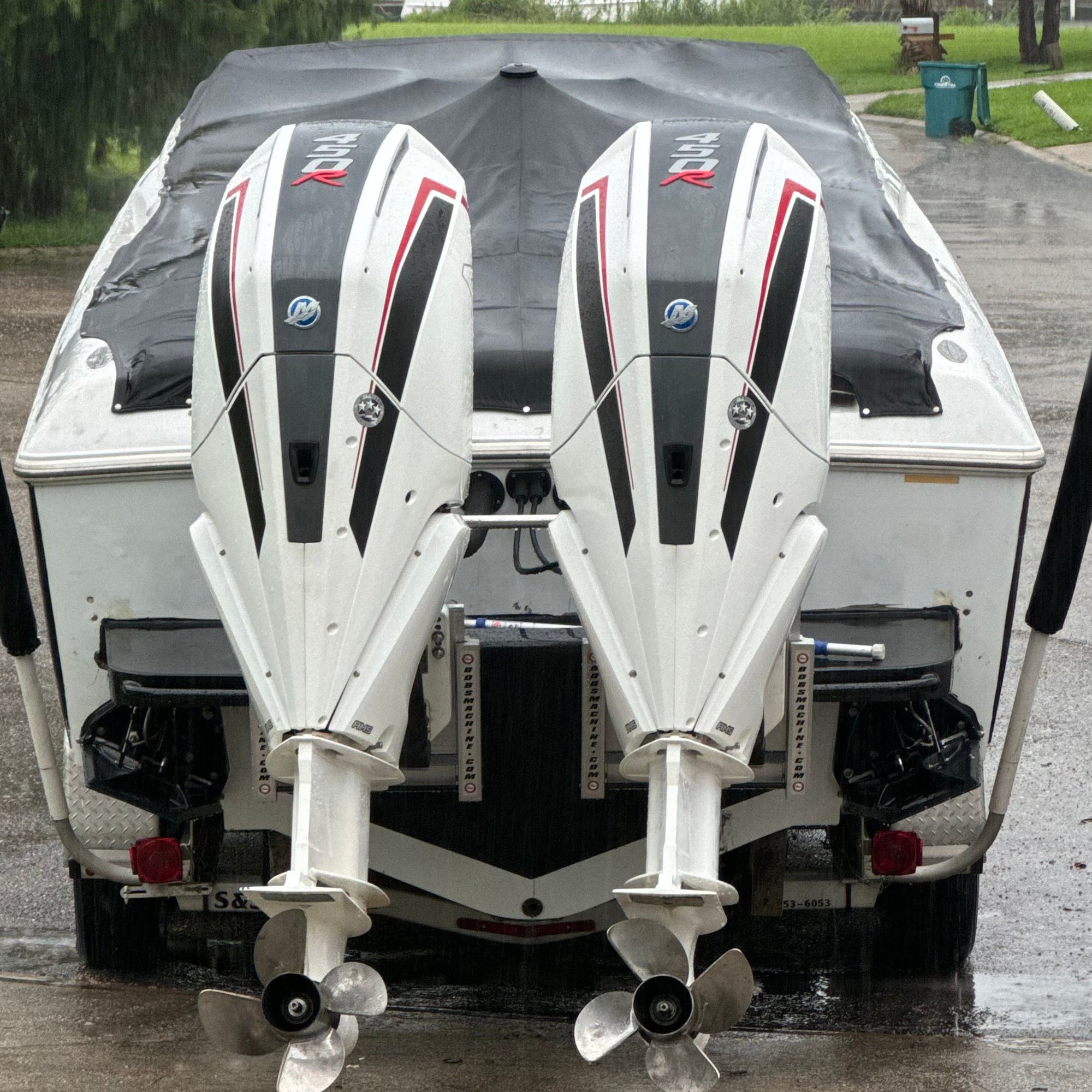

One was welded when I bought it.. Then it got accidentally knocked off pulling out of the shop. All welded back on now.

Well.. after finding a faulty kill switch module. I finally got her in the water!!!
Used the props that came with motors. 23.5p rev 4 XP’s. Apparently these are different than the regular Rev 4s that I was running before. Longer barrel that provide more stern lift and less cup for less bow lift. Boat ran really flat and trim wouldnt bring the bow up. RPMs were around 61-6200, so im close but may need to try some 23p Rev 4s. I have a set of 25p Rev 4s that worked great with the sterndrives, so I may try those just to see if I change the attitude.
Water pressure was good and made a top speed run of…….drum roll please…dum dum dum
77 MPH!! Thats with full fuel (~180 gallons) and 2 guys in boat! Previously only ran best of 68mph light on fuel and just me.
Tried to lift the jack plate, but I was getting a water in fuel alarm. Figured out later, I dont have onboard filters and no sensors.. so bad wire or something. Ordered new fuel filter/water separators with sensors today. Hopefully plugging them in will fix the alarm.
Then I need to take it back out and run it at the 1/2” higher and then keep going to see how slip and handling react!!!
Thinking I can get closer to 80, especially if 1/2 fuel or less and getting Rev 4 props to get bow up.
I have a few sets.
23.5p Rev4 XP too much stern lift and made for stepped hulls
25p Rev 4 Ran great before but will a lil tall for the outboards.
25p Mirages labbed by Bblades. Not a fan of 3 blades, although ran 69 1x!
Probably need 23P Rev 4’s.. Sooo.. I’ll try the 25p Rev 4s to see if I can get the bow up and go from there. If that works.. I’ll just need to swap or get some 23p.
Boat was really stable but rode really flat, but felt pretty good!!
