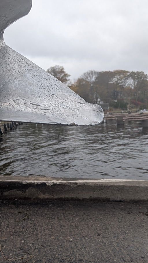

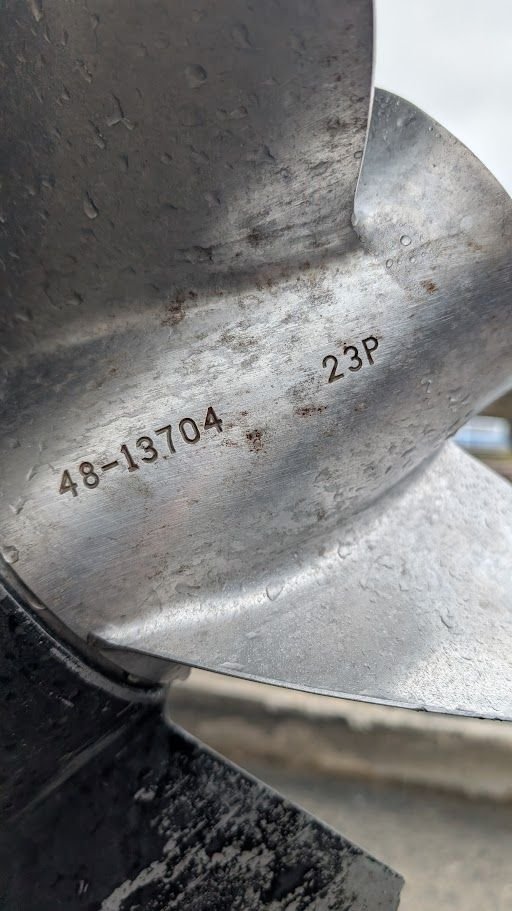

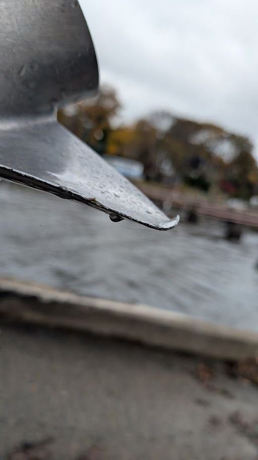

I agree that the speed and RPM are not right. We were checking speed with a GPS not the pito tube. I will have to look at the throttle cable maybe I can adjust it slightly. The other thought was an issue with the drive binding. The previous owner hit something with the prop. (see attached) With this prop, I could not even get on plane. I swapped it with a Mirage Plus 23 we were able to get on plane. Is it possible something is binding up or causing resistence? Some others have suggested a fuel delivery issue. Most of my research suggests poor idle or sputtering if that was the issue. The motor on the hose sounds great. This is only an issue when we are in the water under load. I also read something about not being fully "in gear" simulating an effect of a transmission slip in a car

You are at 25% prop slip at those numbers...ought to be in the 10% range for that boat...SOMETHING is not right. Have you confirmed it is a 1.50:1 ratio on the outdrive? There's a little decal on the top, port side.
For comparison, I am running 52 - 54 mph with the same engine using a Mercury Marine Revolution 4 prop, 21" pitch. I love this prop because of the awesome hole shot it gives if I have people wanting to ski or wakeboard, and holds the turns incredibly well...far better than the Mirage Plus I have tried. So, yeah...bigger boat, different hull and all but still...you have something seriously not right. Maybe a 1.32:1 ratio? Or the prop is just junk OR the hub is spun...which I assumed you checked first but THAT might be the whole problem.
