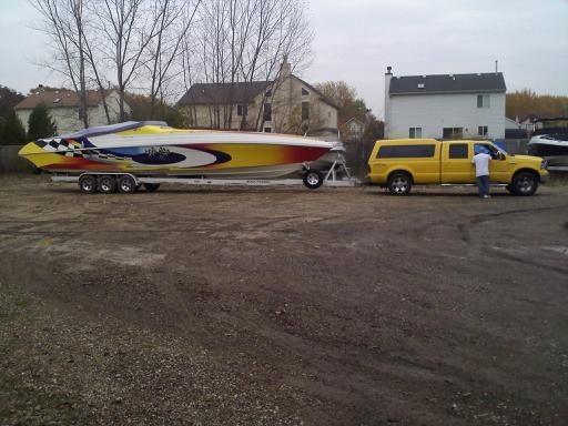

Finally got some time to toy with the new BT and have a couple of questions? number one is what temp is right for a 500efi I took it out and ran it and one motor was running around 180 and one was running around 150 so I took the thermostat out of the hotter motor and it is a 140. Im guessing it is just shot from sitting but am curious if that is the proper stat. number two is there are three acc. switches on the dash no. 1 does the silent choice but I cant seem to figure out what the other two are for. Has anyone ever tried to get a wiring diagram from BT. any info would be greatly appreciated, thanks, JustinAttachment 402871
Attachment 402872

Boat looks great!!! About time you posts some pics!!! You also may want to post this in General Discussion (you may get more info about your 500's)

Nice ride. The three switches on the dash control silent choice, compass on/off and the third on my dash is a dummy. As far as temps go, mine run at 150 all day. Never higher or lower. Bobs in and out of the factory right now but I ll be up to see him next week. What diagram do you need?

NICE BOAT. Switch might be the power point. Higher temp could be weak water pump impeller.
